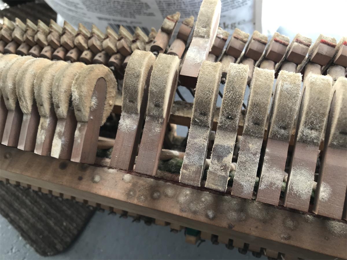

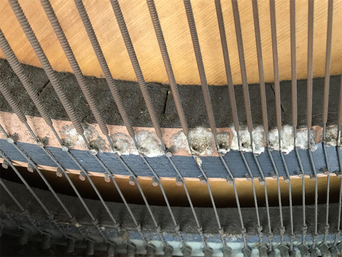

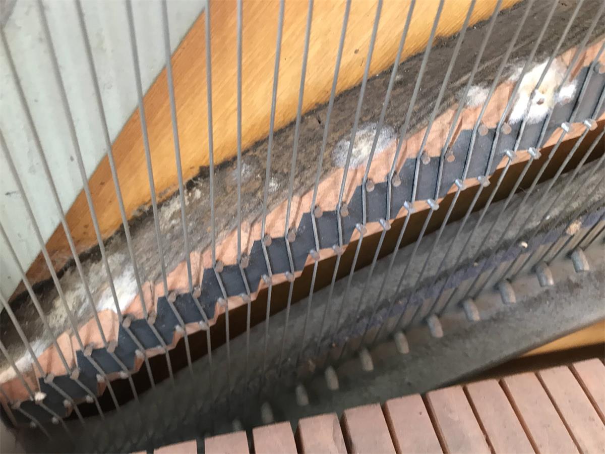

    I'm on a remote island where instruments haven't been looked after very well for years and today was called in to see if I could rescue a piano that had been kept in a damp place. I've asked the owner to brush and hoover it. Is there any anti-fungal liquid that one can spray which won't corrode strings or soften felts? Or is it best to hoover and brush and thereafter keep in an especially dry place?

    I wish you luck with this project. The photos actually show the fruiting body of the mold, not the mycelium. So this means the spores have spread already…..
    I’ve never tried the spray suggested by Gina, but from the looks, you’ve nothing to lose.

    I have used the mold control that Gina mentioned and it works well . You need to protect yourself against the mold spores . It seems as if the piano is loaded with whatever all that white stuff is. You should try to get it positively identified by using a test kit or mold service. Everytime the piano is played mold spores are apt to get released.

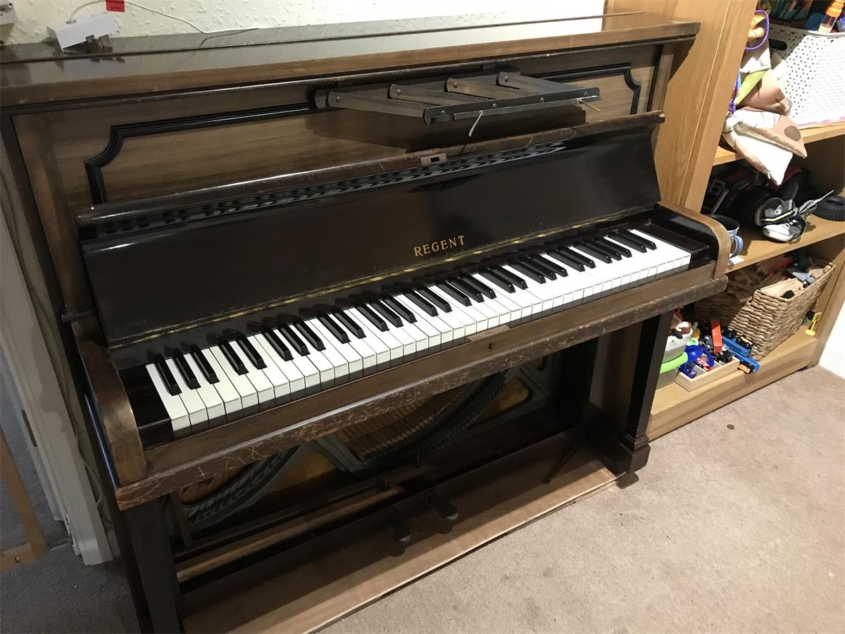

    Dry cleaning fluid used to be flammable but Perchloroethylene isn't. However, not only was there none on the island, but I told the piano owners to brush it, hoover it and put the action in the sunshine for a day or two and upon returning I was utterly amazed at the success they'd achieved. There were a couple of "issues" with the jacks on a couple of notes at top and bottom of the action which I put down to potential damage but didn't need to investigate further as the purpose of the instrument was simply to sound "nice" for a young child to be introduced to music.
    With repair of a string broken at the entrance to the tuning peg coil the tuning was successful although being introduced to a dry atmosphere some pins might need CA treatment in the future.
    It's an interesting instrument, a Regent miniature piano strung all bicord above the wound strings, and other than inharmonicity of short strings, ended up sounding quite nice.
