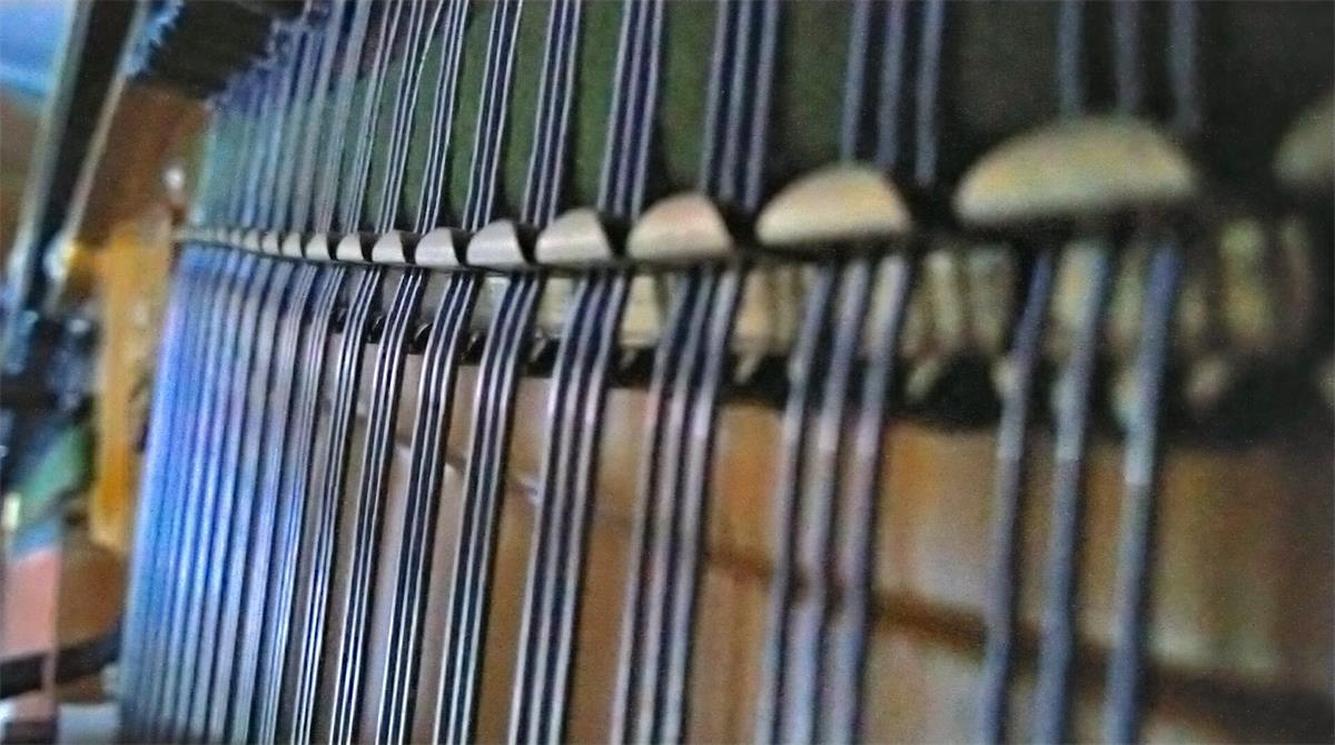

    In tuning an upright Bechstein Model III I came across these agraffes
    I wish I hadn't. With a new pinblock with tight pins you can't tell whether the force on your tuning lever is fighting against friction of pin in block or string through agraffe . . . and with pin wobble one has to be strict about tuning at the 12 o'clock position. A quality tuning has thus just taken me embarrassingly and tediously longer than it should.

    some lube at bearing points might help

    I second that with the lube. It's the very first thing I would do.

    Eventually I did a video about these agraffes. Lube won't help. The
    pressure on the strings is such that the newly restrung strings shows
    mangling and flattening having had to be dragged through the agraffes
    on restringing - and the tech who sold the piano told the customer
    that it was bad to put the instrument through tunings too often -
    clearly knowing a thing or two about metal fatigue caused by the
    dragging through the agraffes.
    https://www.youtube.com/watch?v=k9X2lAcrA0Q

    The art of tuning these instruments is to be vigilant with the tuning
    lever at 12 o'clock and to tap it one way or the other, probably in
    the nature of an impact lever.
