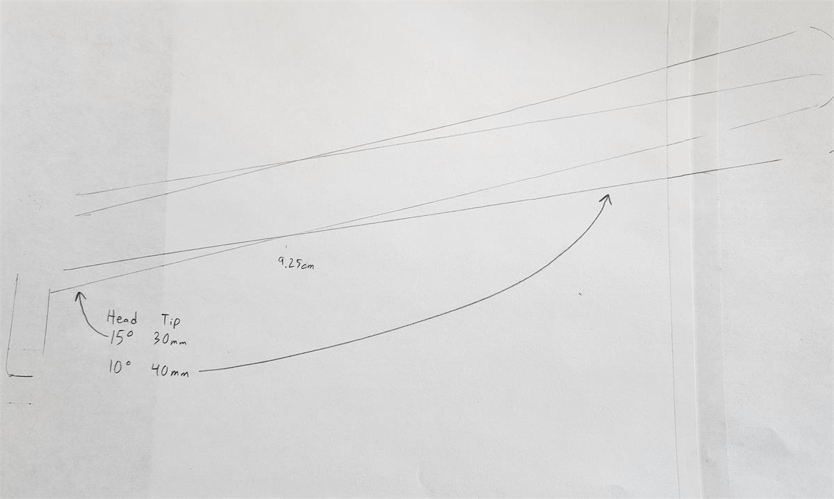

So, my main reason for looking is so I can have a lighter lever...to avoid long term issues. Here is what I found:
Kestrel 6oz (top heavy?)
Faulk 8.5oz (top heavy?)
Reyburn rigid ?.?oz
Fujan 10oz (my current)
Reyburn impact 10.5oz (top heavy because impact)
Cassotto impact 12oz (can be weighted more near head)
And, now understanding that a longer tip means easier flagpoling (which I use in my technique) 40mm is what I am looking for. I also measured and the difference between a 30mm tip/15⁰ head vs 40mm tip/10⁰ head would be

I think this is misunderstood. The extra length of the tuning tip affects how much the tuning hammer flexes the tuning pin, not that the tip itself is flexing any more because it's 10 mm longer. The longer tip has more leverage against the tuning pin and flexes it more. If you have a very long tuning tip, which could be necessary on pianos with tall plate struts, you'll have to be more careful when tuning. If the tip is shorter, it won't flex the tuning pin as much. Of course you can learn to use it in either case. The shorter tip is easier to use if the head angle is 15 deg. because with a shallower angle the lever may not clear a nearby strut. If your tip is long enough, you wouldn't need any head angle at all. But I don't think they make a 0 deg. head, afaik.
