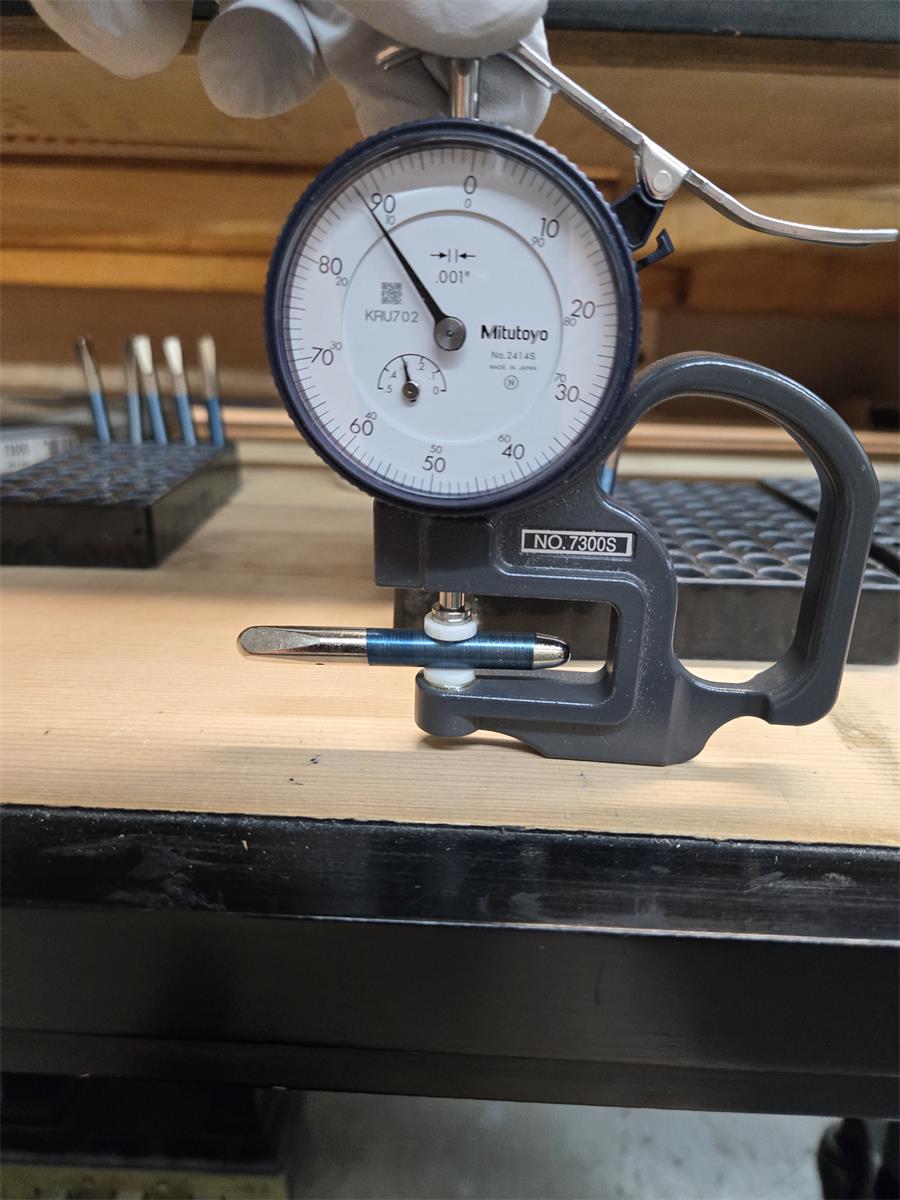

    Prepping a set of tuning pins for stringing today I almost convinced myself that I didn't need to measure all of the pins beforehand. I like to measure all the pins and separate the ones that are a little under spec (.281" for 2/0) for use in the treble and all those over spec for use in the bass.
    2/0 pin slightly under spec
    Above is a pin slightly under by about.001"

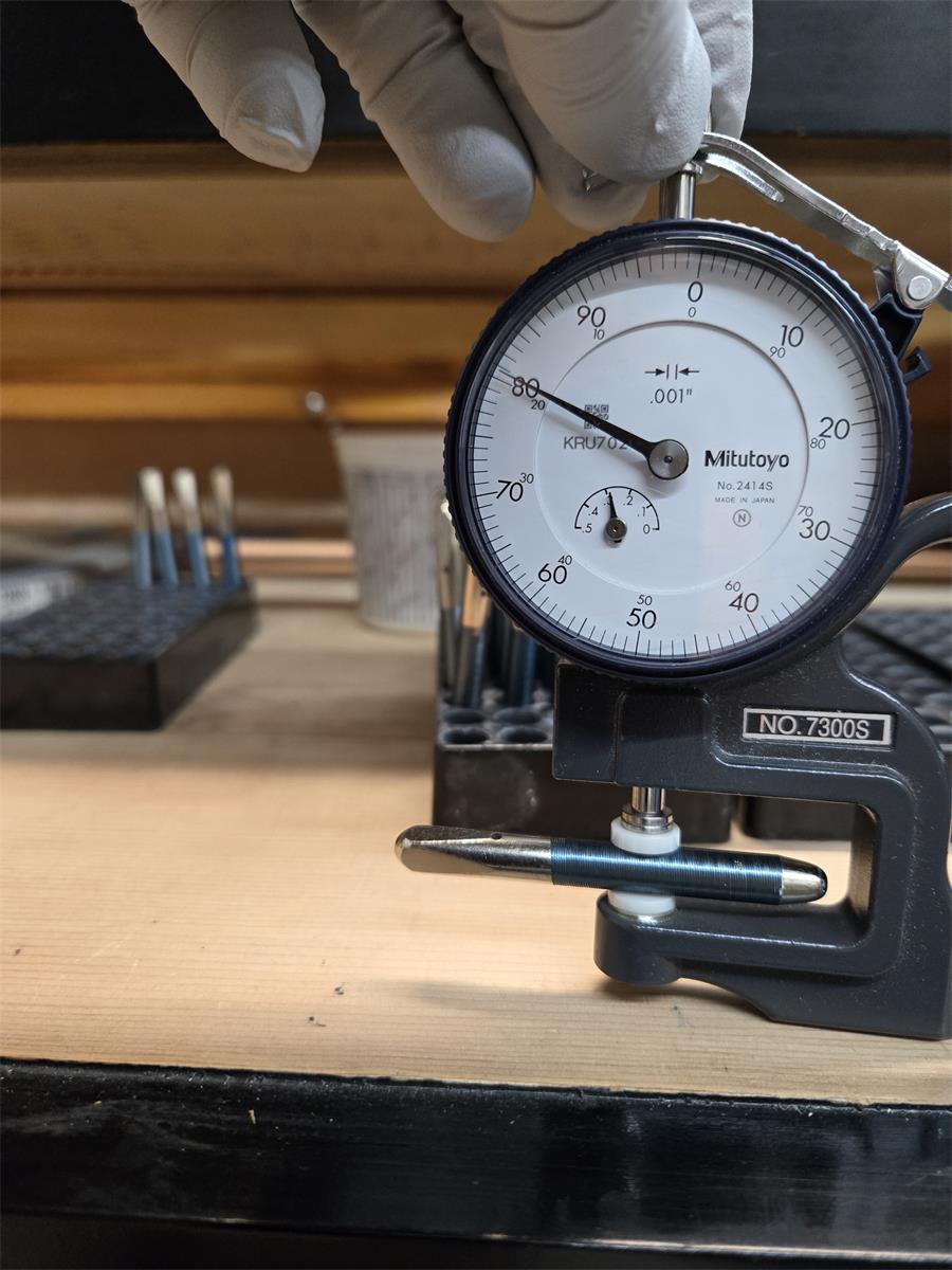

    And then I came to this one.
    4/0 pin in 2/0 box
    That's a 4/0 pin in my box of 2/0s. Since these are going into a new block I would probably not have been happy with how that one turned. Guess I'll keep on measuring all the pins in the box.

    Yikes! Good catch there Karl. Any others like that, or just the one?

    Just the one pin fortunately. I also find about .002" to be the normal variation with Denro and Klinke pins. As Mr. Ballard points out there is often the added dimension of the pins being slightly out of round. There is also some variation along the length of the threads as well. With all of that uncertainty I was starting to think the whole exercise was a waste of time. But then......
