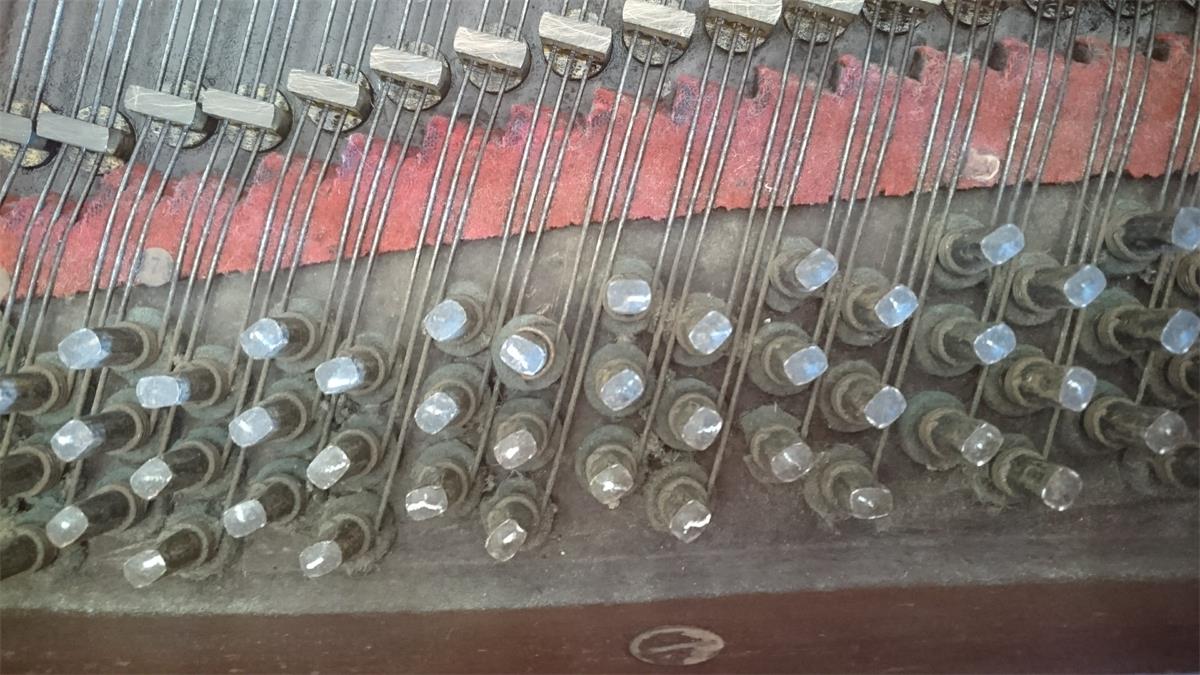

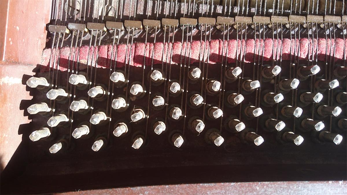

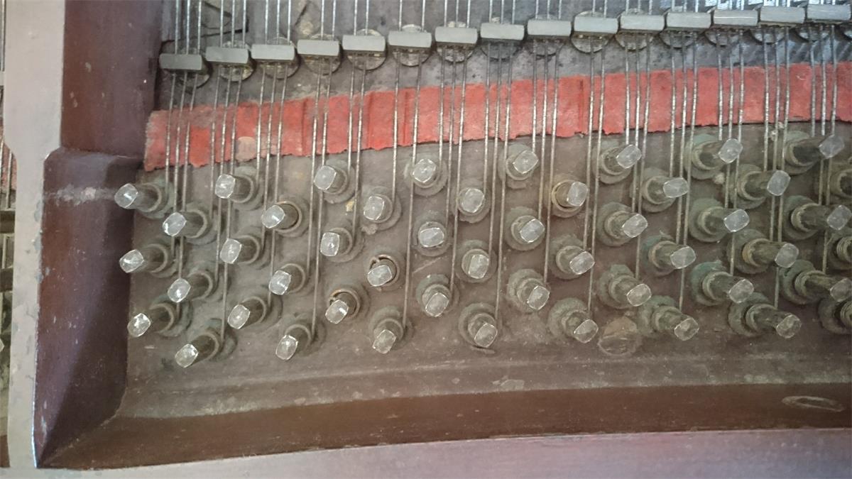

    This week I had the pleasure of bringing Sir Arthur Sullivan's Broadwood (number 2315 - late 1883) neglected for decades back to life at D'Oyly Carte Island on the River Thames. It was a full two semitones down. In parallel to another recent thread about pitch raises in one, I tuned the central octave to 444 and then tuned all octaves in the order of C E G# D F# Bb C# F Eb G B at the end of which the instrument had settled at a stable 436 with only four strings broken. (To my mind if an instrument's strings can't be tuned to 444 without breaking they'll be breaking in the normal course of tuning at 440 anyway . . . )
    Whilst working on the instrument, something dawned on me . . .
    Of course made for Sir Arthur Sullivan one wouldn't expect anything less . . . Has anyone seen anything like this before? In restringing could anyone confidently aim to achieve this now?

    the tuning pins have an interesting shape to them and all have close to the same direction. Full agraffes seem to keep the strings spaced evenly. I am also guessing that there is a hitch pin for each string in other words it is straight strung.

    Yes - standard 19th century oblong tuning pins - but it's the
    alignment of directions . . .
    Yes - individually strung but even so . . . in restringing could
    anyone expect to achieve that uniformity of tuned directions? I found
    it quite a shock when I realised.

    Not really exceptional. Quality restringing keeps all beckets aligned.

    That's only half the point - they're all aligned.
    Larry - good to know that people are still doing this aligning the beckets. I've not come across it before and marvel at it.
    How does one do it? It's not just a matter of aligning the beckets at the start of 3+ turns but bringing them all to pitch with the same angular change.
    So the length of the cut string has to be precise, and the strings correctly scaled to result in same angular movement on each note to result in the same change to pitch. Attempting this looks like a horrifying challenge to me . . .

    By the way, the photos of the rectangular tuning pins that started this conversation, seem to have some type of tuning pin bushing and may not be the same type of machine threaded tuning pin as in the video or that my Broadwood has.
