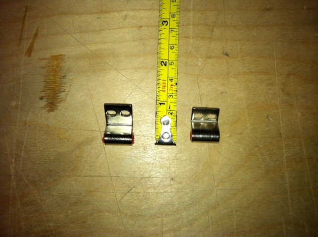

Sent: 03-23-2023 17:18
From: Veronica Jones
Subject: upright damper rod hinge
Sorry to be so late to the party here. We didn't build this piano, but a lot of the hardware specs are the same. It is possible that we may have what you're looking for. I have attached a picture. See if this might be what you need. (There are 2 sizes.)

Sent: 03-23-2023 16:55
From: H. Keith Stephens
Thank you Jurgen. We will call the one closest to the lift rod #1. It is the one that failed. I moved #2 into #1 position. However, it will not work properly without something in the #2 position. I will see if I can make the one from Schaff work somehow when I get it. I appreciate your input.

Sent: 03-22-2023 13:10
From: Jurgen Goering
It's usually the hinge nearest the lift rod that fails. If you need to "customize" something, which may not be as perfect as the original, I suggest placing it further away from the the broken one and replacing the broken one with one of the originals.

Sent: 03-21-2023 16:18
I have only just ordered a few of the hinges from Schaff knowing they would have to be manipulated somewhat. the originals have a 90 degree bend, and looks like the ones from Schaff are straight. So, yeah, some adjustments will have to be made for this one to work. Thanks for the feedback.

Sent: 03-21-2023 15:48
From: Wim Blees
Hi Keith
I know what you're talking about with the damper lifter rod brackets. If I remember correctly, the problem is that the distance from the screw hole to the sleeve where the rod inserts is too short. The way I solved that was to add a thin piece of leather or wood between the bracket and the action rail. And you have to bend the bracket a little. It's been a while since I've done this, and I only did it two or three times, so my memory is a little weak. But thy that and see if it works.
Sent: 3/21/2023 3:14:00 PM
Looking for any info on upright damper rod hinges. The one offered from Schaff is different from one needed and Pianotek doesn't offer one. The piano is Weber upright I believe controlled by Young Chang. The number I have for Young Chang is no longer in service, and on their website the contact page is dead. I have run into this problem before with other pianos too and didn't have a solution. Anyone have any ideas.
