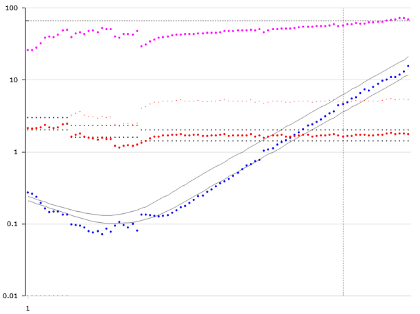

    I think I would be inclined to follow what is stamped on the bridge. The below data came from North Bennet Street School and was represented as original but I am not sure that the plain wire sizes have not been tweaked. The DIAM numbers are in thousands but the actual calculations are based on the smaller metric diameters. So 13.5 = .032 is calculated using .0315 as a diameter. Metric wire of the same gauge as American are .0005 smaller gauges 12 through 14.5 , .0006 smaller gauges 15 through 18 ,  .0007 smaller gauges 18.5 through 21 , .0008 smaller gauges 21.5 through 22.5
    Gauges 23 and up are nearly the same (23 = +.0002, 23.5 and up +- .0001) Graph included below data.
    Piano Mfg/Info/Filename: yamc3o.txt / YAMC3NBO |
    Default Unified Gauge Method.
    Use Metric Core Wire is checked. TEN, Brk%, and INH are correct. Calculated with actual smaller metric plain/core wire conversion sizes.
    Note Type SPLM GAUGE DIAM DIWO TEN Brk% INH ATSD
