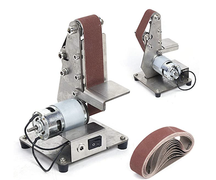

    I've been using my 6 x 48" bench belt sander w/250 grit and set up vertically for a long time. I put a small block of wood on the sander table as Jon mentioned. I'd always struggled with hand filing. With this it takes about 10 seconds per hammer and with the fine grit you can go straight to using the finer sanding strips even if the hammers were really bad to start with. I'm not sure removing the hammers on a grand and filing on a machine is that much slower as I can do in one pass and get good squared-up results. I have a spindle sander but it's reciprocating and I didn't like the way it felt. The one advantage a spindle sander might have is that it's cutting in the same direction as the felt fibers are laid out but with 250 grit I don't think that makes much difference. Like Jon and Alan, I've never wrecked a hammer, you just use a very light touch.
    Like I said above, I include it with the silk loop jobs, it doesn't add much time at all and adds a lot of value to the job as well as giving one more control over lining up the hammers to to the strings.
    For me, it's worth the extra time to get the results. And in the case of silk loop replacements the hammers are coming off the rail anyway.
    I recently got this tiny belt sander for remote work. It seems okay but in the shop I think I prefer the big sander. The little one weighs 2.2 lbs and stands about 12" high.
