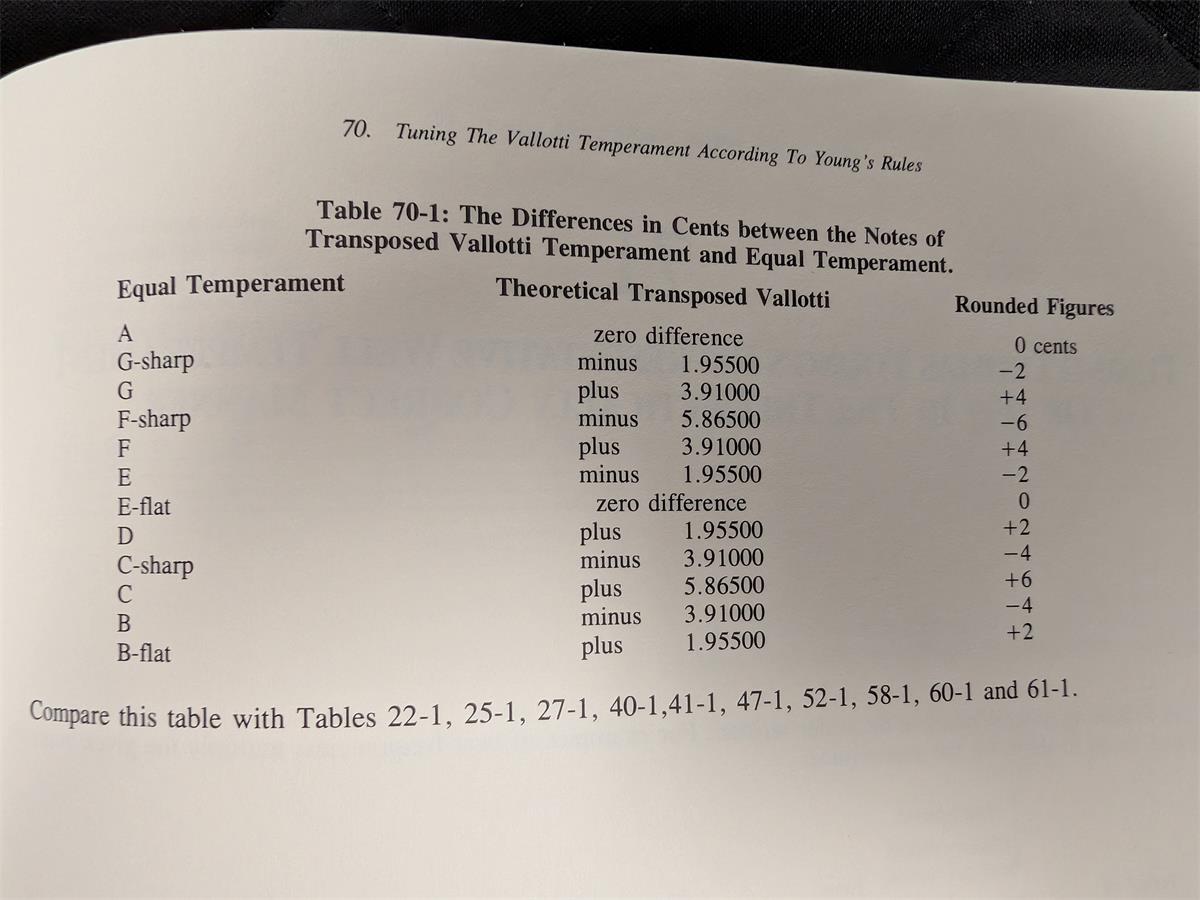

    The "Shifted Valotti-Young" temperament loaded into my Verituner is virtually the same as Wesley's but is carried out one additional decimal.
    For what it's worth:

    Young #2 = shifted Vallotti.
    I've got the same offsets as Steven.

    Here is the table for Owen Jorgensen's temperament book, in case you wanted a copy of it.
    We tune our harpsichords to Young 1, 1/6 comma, and/or VY all the time.
