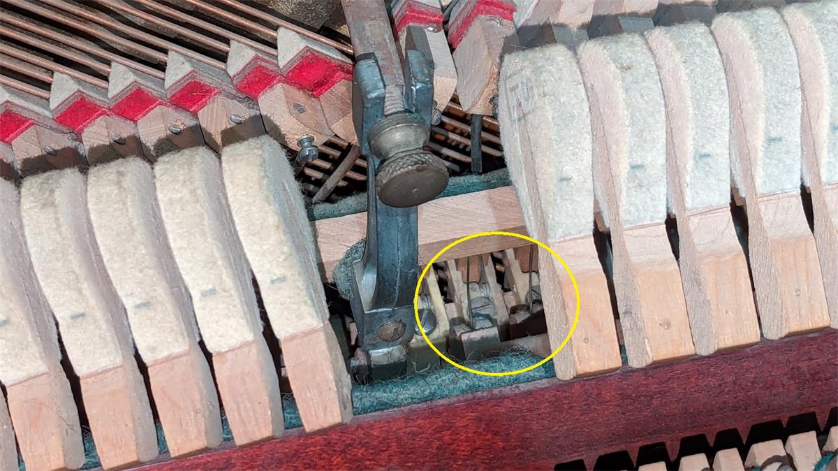

    Hello,
    I have a customer with a broken plastic damper flange on a 1950s (I think) Chickering console. I'm assuming there is no reason I couldn't replace with a wooden one?
  • 2.  RE: Broken plastic damper flange
    Posted 04-04-2024 13:37
    Yep, you should be able to replace it with a wooden one, assuming it's the same size and shape. Be careful though! It's very easy to break surrounding plastic parts. Good luck!!

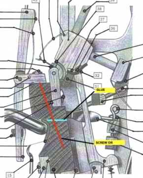

  • 26.  RE: Broken plastic damper flange
    Posted 04-06-2024 14:16
    Well, I couldn't find my own pictures but found this cross section on the net. Perhaps the rail doesn't need to be laminated if the stock is quarter sawn.
    The blue line is where the glue joint is more or less. The red line is where I put the screws and/or dowels after gluing and clamping as best I can. I haven't seen one that completely separates but have seen them separate all the way down to the beginning of the bass. Some but not all of the dampers and whippens need to be removed. Reinforcement can also be put in on the 'shelf' below the hammer flange but that is a weak point too, I recommend at least a few diagonals be installed too.
    (in the diagram "screws or" = "screws or dowels"; "glue=glue joint. That's what I get for trying to do this before the 1st cup of coffee)
    Some people take short cuts but this isn't a job one wants to do twice.
  • 27.  RE: Broken plastic damper flange
    Posted 04-06-2024 14:20
    Btw, even if the rail doesn't delaminate all the way to the bass, anchor it at that end as well. The glue could fail from the bass sustain rod at a later date. Don't ask me how I know.

  • 29.  RE: Broken plastic damper flange
    Posted 04-07-2024 17:15
    Ryan, you're welcome, hopefully I personally won't face this job again, however, I've been mulling this over since it's come to mind and have a few more tips for the job.
    > For clamping and gluing I have some small pieces of wood with a grooves cut in them so as not to damage the raised molding on the rail, I suppose  flanges will work fine for that.
    > I have some 6" drill bits for drilling the pilot holes for the screws and I drill a pilot before drilling the 7/32" hole for dowels. Without the long bits you will probably have to remove the hammer spring rail or else it will obstruct the drill chuck.
    > If you have the action in a cradle, you will want to brace the action rail from underneath when drilling and installing the screws/dowels.
    > Directly behind the action brackets are convenient places to use screws.
    > I use dowels near the damper rod hangers where the upward force is acting on the action rail. I will do this down to beyond where the split is opening up.
    > One reason to use dowels is that if you're gong to put them where there are damper levers are they need to be flush with the rail as the damper flange will rest on top of them. Note: not only is the action rail laminated, many of these pianos use (wood) flanges that are made of laminated strips as well, probably to  make use of trimmings from other parts. And they used the same bad glue on these as they do on the rails, so it's not uncommon to find the flanges coming apart into two pieces when you remove them from the action. They can be reglued or replaced. Be prepared.
    > The damper screws are offset to the hammer flange screws and there is room for a 7/32" dowel between the damper flanges.
    The reason for all this redundancy is because short of removing all of the dampers to reglue the two pieces, I don't want to rely on just the glue joint  in the future, by only removing a few damper levers as needed, I get as much glue as I can but I think that is only good enough to hold the pieces in position while installing screws and or dowels. The upward thrusting damper rod exerts a shearing force on the rail and this repair will insure it stays rigid.
    With these procedures one can keep the labor down to a few hours on the bench and there should be little to no additional damper regulation.
