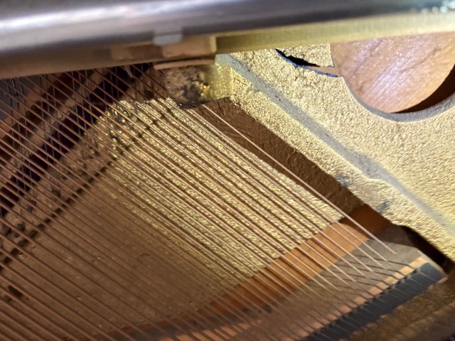

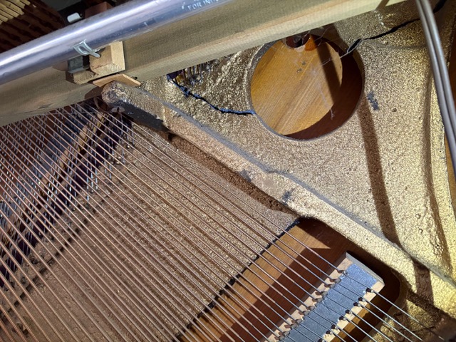

From Terry's description of what took place, I would conclude that at least a hairline crack (possibly, but not necessarily, visually detectable) existed before he started. 50 cents flat equates to: "This piano has been severely neglected..." and I would suggest probably moved from one location to another I between any "tunings".
Plates break only when there is a manufacturers defect of one form or another, or they have been damaged by sudden shock (e.g., falling backward flat on it's back or some such thing), usually unknowingly. If I had to take the time to inspect every square inch of each piano I service to look for cracks, I'd give up.
By the looks of his crack I would strongly suggest that tge piano suffered a trauma somewhere in a move and nobody knew. Years later they decide to get it tuned...the rest is history.
No liability. However I have seen one owner go berserko over the situation threatening legal action, etc. It took the combined effort of the Chapter president at the time and at least one more tech to convince her that it was a pre-existing condition (yes, it was a PSO) and that tuner was not at fault.
Stuff happens. I'm sure though that some circumstances somewhere my point to liability but that would be extremely rare.

While raising the pitch on a POS Lester spinet about 50 cents the other day, I finished raising the pitch, felt good that no strings broke, and as I usually do immediately upon finishing raising the last note (C88), I start sounding the notes, one-by-one, while watching my Verituner display to see how close I came to the target pitch. C7 to C8 was pretty close, then as I went further down the scale in the treble, it kept getting flatter and flatter until at the lowest note in the treble, it was like 80 cents or so flat (more flat than before the pitch raise!). I thought WTF - I've had a few pitch raises come out a bit off, but nowhere near THAT bad! And then before I could think another thought - BAM! The guy (owner) was out in the back yard and came rushing in and said: "did a string break"? I said "no, a string does not make that loud a bang - I'm quite sure that had to be the plate. I hate to tell you but I think your (lovely!) piano just died a violent death!".
I presume the plate was compressing/bending/whatever-it-was-doing - but certainly changing shape until it actually broke. Could not have happened to a more deserving piano! ;-)
I wish I could post pictures, but I still can't download pictures from my new iPhone. :-( Plate broke just below the low treble hitch pin area and had a good 1/4" displacement.
2nd plate that has broken on me in 26 years. FWIW, it DOES happen!
