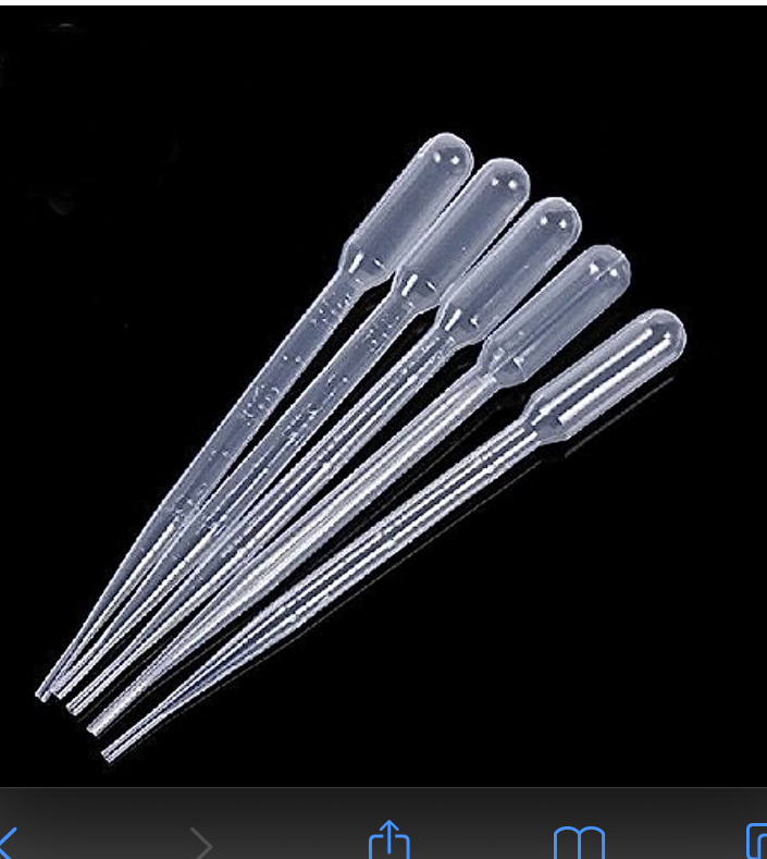

    Scott,
    any time I have tried to use a 'needle' with superglue, it has clogged it up within a few minutes! what is your secret?
    603.312.5169
  • 16.  RE: CA for troubled concert Steinway?
    Posted 07-03-2024 13:42
    I use these pipettes
