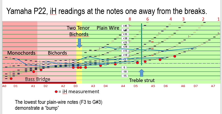

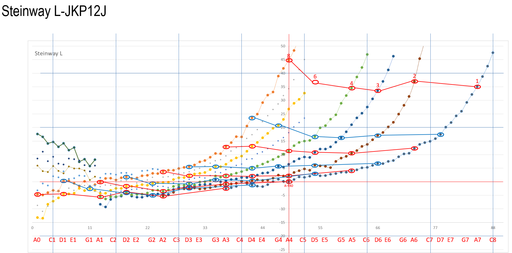

    I'm interested in extracting the partial data because it's so interesting to see them graphically.
    Here's something I made using TuneLab's data:
    and here's something using Verituner's data:
    I have a lot more of these, also data from Anthony Willey's Pianoscope app (with his invaluable assistance to setup the data extraction process). Slowly noodling a series of Journal articles. The attachments are other examples. Ask away.
