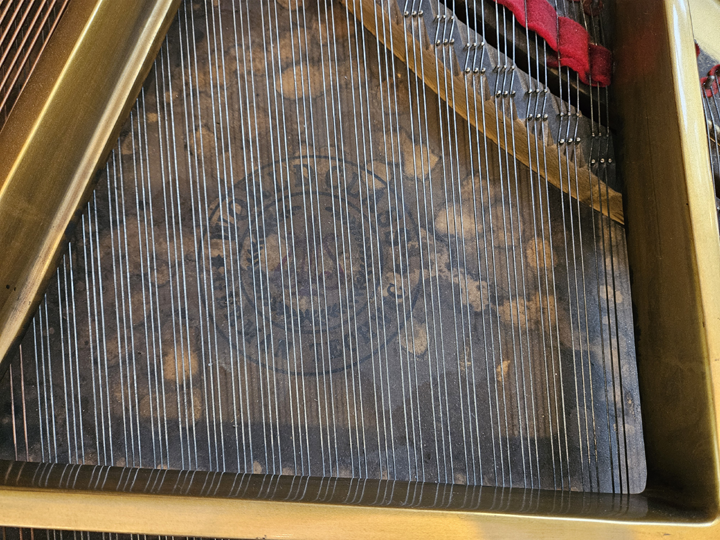

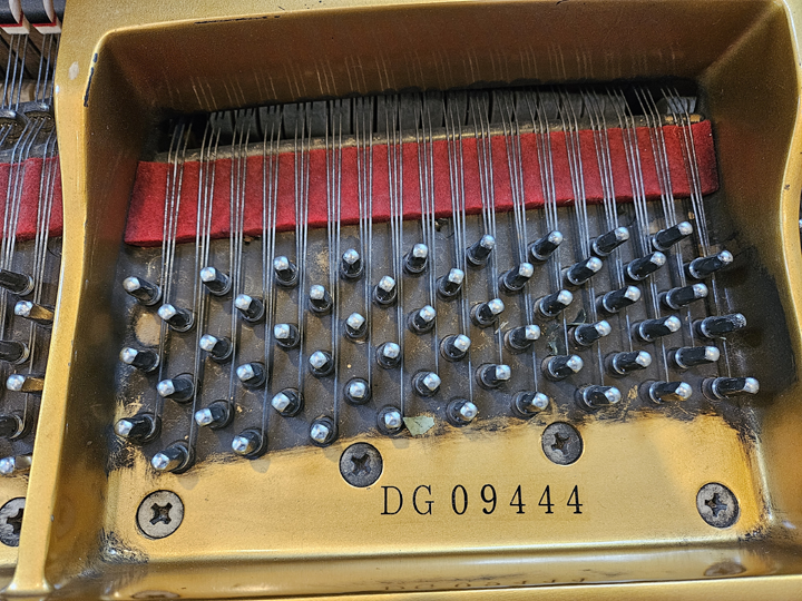

    How to clean up soot? Not that old Hallet Davis baby grand made by Samick. I can't decode the sn, and numbers in the DGO range aren't listed in Pierce, but I'm guessing 15 to 25 years old. Hardly ever played but lived next to an extremely poorly vented fireplace since new. As a result the inside of the piano is covered in thick black soot. There is nothing to indicate that this could be home fire damage. It's just soot that covers the top of everything. New owner, (received it as a gift from her father who bought it from a private party), has already cleaned up what she could get to but the rest needs cleaning badly. Soot is greasy and can't just be vacuumed up or easily wiped off. I'm looking for suggestions on how to approach this task. See pics.

    You're never going to get all the black soot out of the piano, but you can make it look a lot better.
    For the soundboard, use a rag that's been dipped in a bucket of warm water and Spik and Span. Squeeze out most of the moisture and push it under the strings with a soundboard steel. Remove the action and push the rag all the way to upper octave and take it out with your hands. Repeat as necessary.
    For the pin area, spray a section with Scrubbing Bubbles and let it soak, then dap it up with cheese cloth. Repeat as necessary.

    As for the serial number; I am intrigued as it doesn't seem to fall into the supposed pattern, unless the piano was made in the 1950s.
    I may do some investigation.
