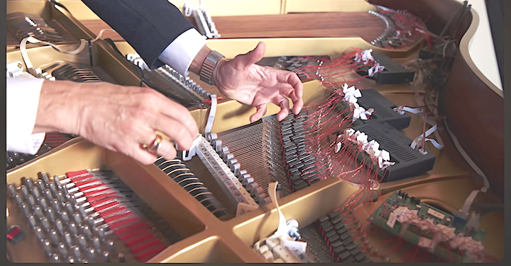

    Posted 10-31-2025 15:33
    While the an over the string magnetic sensor will probably give the strongest signal, the downside is that they are labor intensive. In addition to the 88 hand movements to position them from note to note, there are 2 additional movements whenever you use them to go back and make checks for drift etc.and they are bigger movements over intervals and octaves. This is a disincentive to making a lot of checks and could rub up against time constraints in the situation Alan was in. Mics or the less sensitive piezo pickups, require little or no extra placement issues.
    Don Gilmore, inventor of the self-tuning piano, uses infrared sensors to read the frequencies of the strings and induction to control the temperature of the strings, lots of hardware. After over 20 years, still a work in progress. https://www.youtube.com/@dongilmore8681
