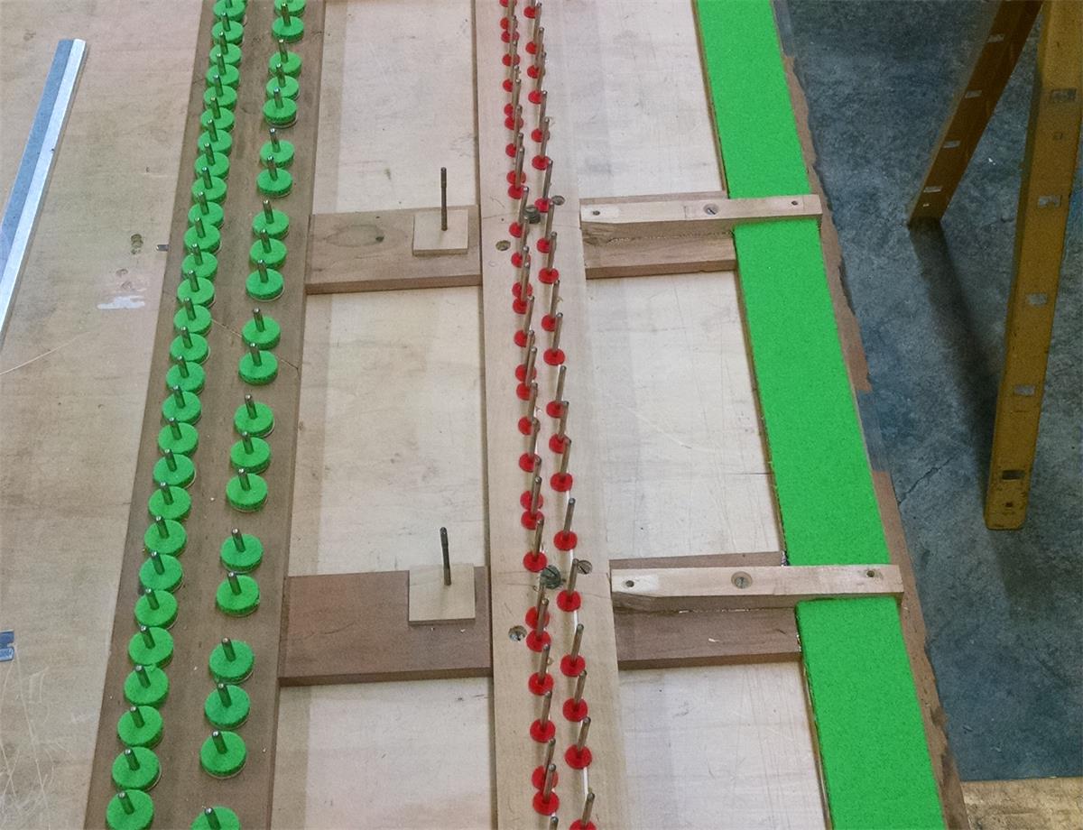

Cutting punchings will do the former. So does the Steinway half round bearing and so does just cutting a section off the proximal side of a balance rail punching or buying them made that way as you used to be able to from Pianotek
But when we have a weight problem the issue is always a mismatch between the AR and the SW (friction issues aside). So to fix that you have two choices, change the AR or change the SW. That's it really. Cutting punchings does not change the AR. It does change the AR at the end of the key stroke, or starting about halfway through, but it will not change the AR at the beginning of the key stroke where it counts the most. An action that is mostly in compliance will benefit some from cutting punchings but it won't solve a fundamental weight problem that results from what I describe and is fundamental to the Stanwood or Fandrich-Rhodes system. If you are inclined to cut punchings there are other ways to do it that are less invasive and more easily reversible should you decide to address the problem in a more fundamental way later.

It's funny timing, I just finished rebushing the keys of my Yamaha C5 that I've had for over 20 years. I trimmed all the BR cloth punchings and glued them to the keys while I was at it. I played it a while this evening and it felt amazing. The trills were much easier than before.

Yes, strong language but some practices are done more out of habit than real utility. Perhaps it was too strong. It will help but not as much as placing a shim underneath the back of the balance rail punching. The reason is that the key goes through a change in ratio as it moves through the stroke. We all know that. At rest the key sits fundamentally flat on the balance rail punching, maybe favoring the back slightly. As it rotates forward the point of contact moves to the front of the balance rail punching and as it does that key ratio rises and along with it the action ratio. When you cut the front of the punching it keeps the fulcrum from migrating forward and the key ratio remains more constant through the stroke. Pianists will feel something because of that. But inertia is a problem mostly at the beginning of the key stroke, when we are starting something moving, not at the end, when it's already moving. By shimming behind the balance rail you move the fulcrum to the distal side of the key dropping the key ratio from the outset. The downweight will drop about 4 grams (and the inertia along with it because you've change the AR) with that method at the beginning of the stroke where it matters. If you're going to bother to alter the balance rail punching my recommendation is to do it that way, less work and easily reversible too. No cutting and gluing of punchings to the bottom of the key. The simple test for whether you've changed the action ratio is if the regulation specs change. If they don't, you haven't. Cutting punchings will not change the regulation. Inserting a shim will. See attachment (I've posted this before). A little hard to see without zooming in but there's a strip of veneer behind the balance pin underneath the BR punching.

You state: "cutting the front of punchings is not a solution and won't help you" this is pretty strong language. Experiences (not just mine) over the decades teaches otherwise. Just yesterday I was preparing a rebuilt vintage Mason & Hamlin A for a 4 handed concert at a local library. All fine with the condition, regulation, voicing. The pianists had been rehearsing for 5 days and both felt the bottom half of the piano was heavy and challenging to deal with. The only solution I had time to execute was to cut the cloth punchings to the back side of the BR hole and hide glue the bits to the bottom of the keys tapering to full punching mid treble. It took about 45 minutes to execute. I know the performers well and trust their feelings and judgement. One is a North Bennt St Scool graduate. I got a text after their final rehearsal before the concert. "the piano is great". A little background on this subject at: https://www.stanwoodpiano.com/December2014.pdf I don't understand your reasoning that "the shim actually changes the fulcrum position from the beginning of the key stroke. Cutting the punching only changes it at the end of the stroke".
