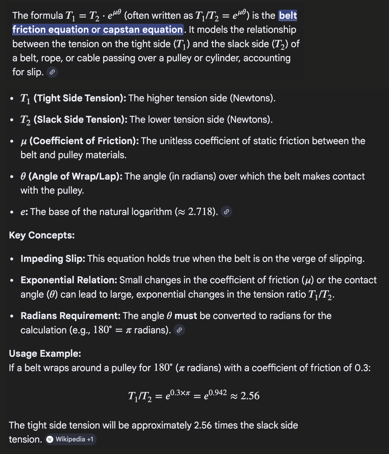

    Capstan equation  ->  T₂ = T₁ · e^(μθ)

    Dylan, thanks for bringing this up. Years ago a mechanical engineer told me that the bearing points act as pulleys but didn't explain it. It shows how changing the angle of a string over a bearing point can have significant effect, thus the importance of the elevation of the string from the coil to the bearing point. (Changes in the coefficient of friction)
    It's worth thinking twice before adding/subtracting coils or tapping down tuning pins. More to Dylan's probable point, smaller wire is more flexible and easier to coil tightly, and the lighter tension strings may benefit from the extra grip. Larger wire carries more tension and is stiffer, so 3 coils gives sufficient hold without adding unnecessary friction that would impede tuning accuracy.
