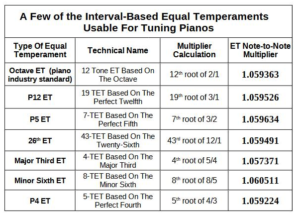

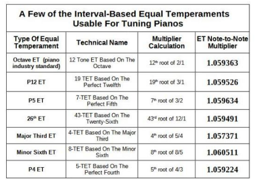

    Here's the math for both octave ET and pure-12 ET
    >> 2.^((0:12)/12)
        1.0000    1.0595    1.1225    1.1892    1.2599    1.3348    1.4142    1.4983    1.5874    1.6818    1.7818    1.8877    2.0000
    >> 3.^((0:19)/19)
        1.0000    1.0595    1.1226    1.1894    1.2602    1.3352    1.4147    1.4989    1.5882    1.6827    1.7829    1.8890    2.0014    2.1206    2.2468

    Kent makes the point that people use ad hoc stretching of a Pure Octave ET anyway, and Kent suggests it is typically 1 cent. The Pure12th ET makes that 1.2347 cents. It is a minor difference. Here I just did the math:
    Conclusions: for every interval, including all the 3rds, 6ths, major and minor, as well as the 4ths, 5ths, etc., one can only conclude that
    -- The differences are within a hundredth of a cent, so why bother? Just use the Pure 12th ET to do the stretch you would do anyway!

    This table is FYI. We discussed several of these musical interval ET's a couple years ago on this listserver. (In general, there is an infinite number of possible "general" ET's.) Maybe some of the rows in the table relate to the variability available in Verituner that Kent talked about earlier ("style files"), or in other ETD's. Regards, Norman.
  • 53.  RE: Piano Temperament Pure 12th
    Posted 04-17-2024 10:45
    That's an interesting table of the note-to-note ratios for various kinds of equal temperament.  I think those figures assume zero inharmonicity.  So I wondered how inharmonicity might affect them.  Obviously it could be different on pianos with different inharmonicity, but for a typical piano, I looked at the P12 tuning.  In the table it says the note-to-note ratio is 1.059526  (the 19th root of 3).  Indeed this is just what it would take to make 19 repeated applications of going from note to note (which is a 12th interval) to result in a pitch that is exactly the 3rd harmonic of the original pitch.  But if we want to match the 3rd partial instead of the 3rd harmonic, we have to shoot for something higher than 3.  My calculation on a typical piano shows that the note-to-note ratios matching the 3rd partial would be:
     C3 to C#3 = 1.05957
    C5 to C#5 = 1.05959
    C6 to C#6 = 1.05979
    C7 to C#7 = 1.06005
    I limited the calculation to 6 significant figures because I only had the frequencies calculated to 6 significant figures.  But even with only 5 decimal places the differences between sections of the scale and the differences from a zero-inharmonicity value are apparent.

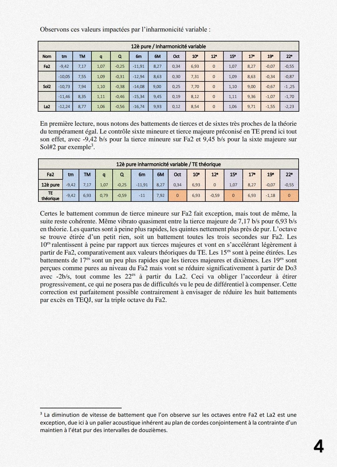

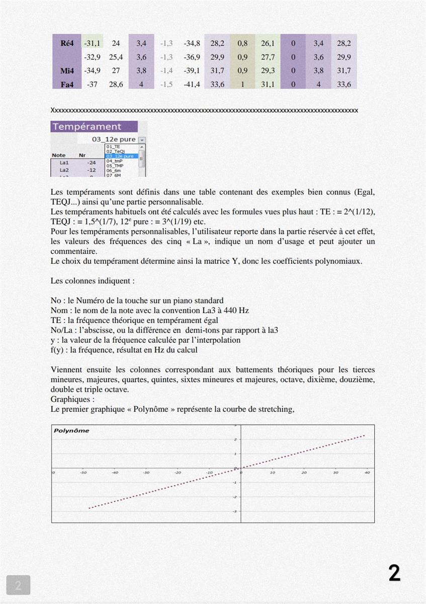

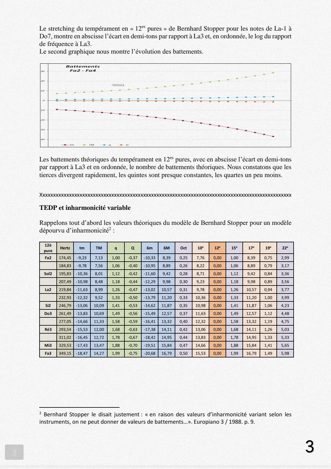

    The following content is from this book《Le Clavier Bien Obtempere (essai de temperamentologie)》
    ISBN : 9782954140131
    You can also watch two videos
    EuroPiano France
    https://m.youtube.com/watch?v=FrY9T7iJ4MM&list=LL&index=49
    Russia
    https://m.youtube.com/watch?v=1ByiOAiz-34&list=LL&index=48&t=13s
    Zhanxi Huang
    Benxi
    86-18741420582
