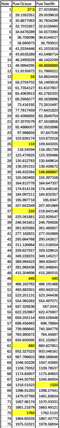

    But the octaves don't come out pure anymore. They are all stretched slightly wide of pure. The fifths, which were all a bit narrow in regular 12-tone equal temperament, are a bit less narrow. The fourths would be a bit more wide.
    All of this has nothing to do with real pianos until you notice that when you're tuning a real piano you have to stretch the octaves a bit (looking only at the fundamental frequency) and that if you look at how much the stretch is in the midsection, it's close to what you'd get if you were just using the frequencies from the theoretical perfect 12th equal temperament. It's not a lot of stretch, and this relationship breaks down very quickly in the treble and bass where we need a lot more stretch on real pianos.
    If you'll forgive a too-long table, here's a table of the frequencies for the theoretical pure octave and pure twelfth equal temperaments. I've highlighted A=440 and the frequencies where that reference frequency doubles/halves (for octaves) or triples/thirds (for twelfths).
    If you squint you will see that these two sets of frequencies are really close to each other for any given note. They diverge by 1.23 cents per octave, so at the top and bottom of the piano the notes are 4 and 5 cents apart respectively. Much less than the 20-50ish cents of stretch we often use in the bass and treble.

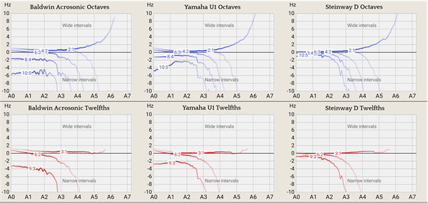

    Of course you can't tune both the 6:2 and the 3:1 pure in the bass. To see why, let's look at some real physical pianos. Here are some images showing the calculated beat rates of all the octaves and twelfths on 3 pianos: a Baldwin Acrosonic, a Yamaha U1, and a Steinway D. The graph is based off the lower note of each interval, so if you care about the A3-A4 octave, look at the point labeled A3.
    On all these pianos the 2:1 octave is wide. It must be. But on the D it isn't nearly as wide. The big difference comes when you look at the 4:2 and 6:3 (and higher number) octaves in the tenor and bass. On the Steinway they are all quite close together with near zero beat rates. On the Yamaha the 8:4 is impossible to tune pure without messing up the 6:3; and the 6:3 and 4:2 never quite converge the way they did in the Steinway. The Baldwin has the same issue as the Yamaha except it's worse, with the 8:4 beating at 2 Hz throughout the tenor and bass instead of 1 Hz on the Yamaha.
    The twelfths behave similarly. The 3:1 twelfth is surprisingly pure on all 3 pianos, but more so on the Steinway. The 6:2 and the 9:3 on the Steinway converge in the bass, but they remain spread on the Yamaha and Baldwin. In other words, you can have the 3:1 and the 6:2 both sounding pure in the Steinway's low tenor and high bass, but you're going to have to compromise on the other pianos.
    By the way, since we're looking at beat rates, these graphs are a bit misleading because they blow up on the right side (because the frequencies are doubling each octave and are really high in the treble) and the difference between intervals looks really small on the left side because the frequencies there are so small down there in the bass. It can be helpful to look at the same graphs plotted in Cents instead of Hertz or Beats per second.
    Now the graphs seem to blow up in the bass, where even a small frequency difference equals a lot of cents, and they don't blow up as much in the treble.

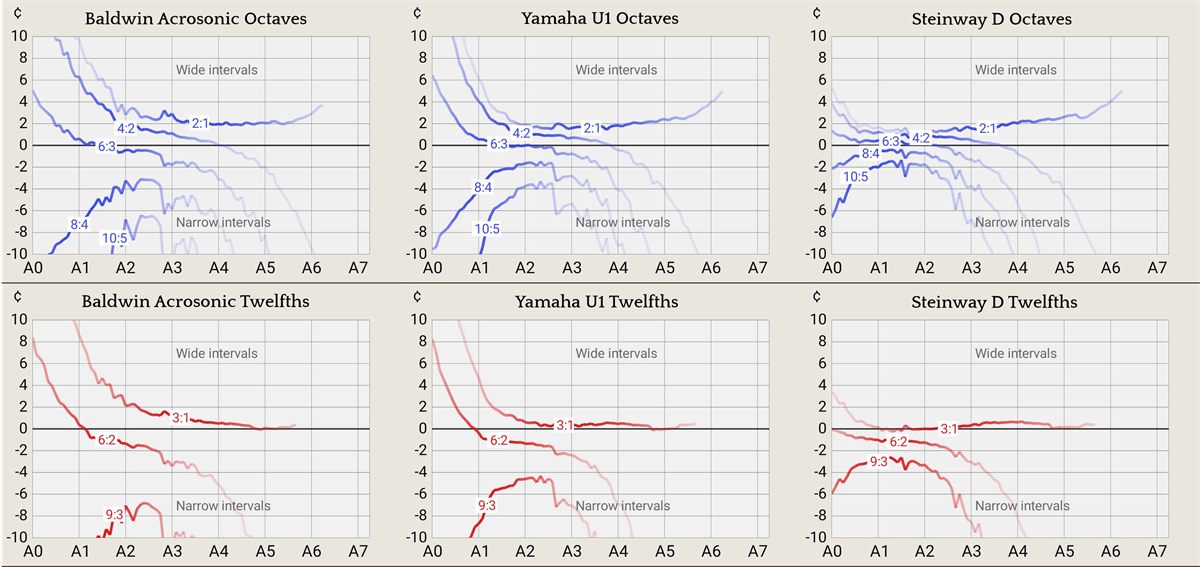

    Looking at the cents graphs, you can see that the 2:1 octave is generally tuned about 2 cents wide for most of the range where it matters. The 4:2 octave is tuned fairly pure in the midsection, and the 6:3 octave takes over in the tenor.  8:4 and 10:5 must always be narrow.
    For the twelfths, 3:1 is pure throughout the piano except for the bass where it's forced wide by other intervals including the 6:2 and eventually 9:3. Except on the Steinway. Long pianos really are nice to tune :-)
    Getting back to the original topic, what do these images have to do with theoretical pure twelfth equal temperament? Nothing really I guess. These are real tunings for real pianos and as such they're a big compromise between many competing intervals. But the 12th, especially the 3:1, is a good interval for most of the piano. If you had to pick one interval to tune pure from the tenor to the top of the treble, the 3:1 twelfth is the best choice. And it is given a lot of weight in the ETD (PianoMeter) that calculated these tunings. Other ETDs calculate the tunings with different methods, but the results are similar I believe.
    Another takeaway from these graphs that I'd like to emphasize again is that the 2:1 octave is never tuned pure in the treble. It should always be wide. You can do that with the double octaves or the twelfths, and I think it will also just happen naturally if you're just working your way upward aurally with octaves, fourths, and fifths. Deliberately tuning pure 2:1 octaves up through the treble will probably sound fine, but you'll be forcing literally every other interval narrow, and you'll end up with around 10 cents less stretch by the time you get to C8.
    Well, I was aiming for something easy to understand, but I think I went too long. If you read this far, I hope it was helpful.
