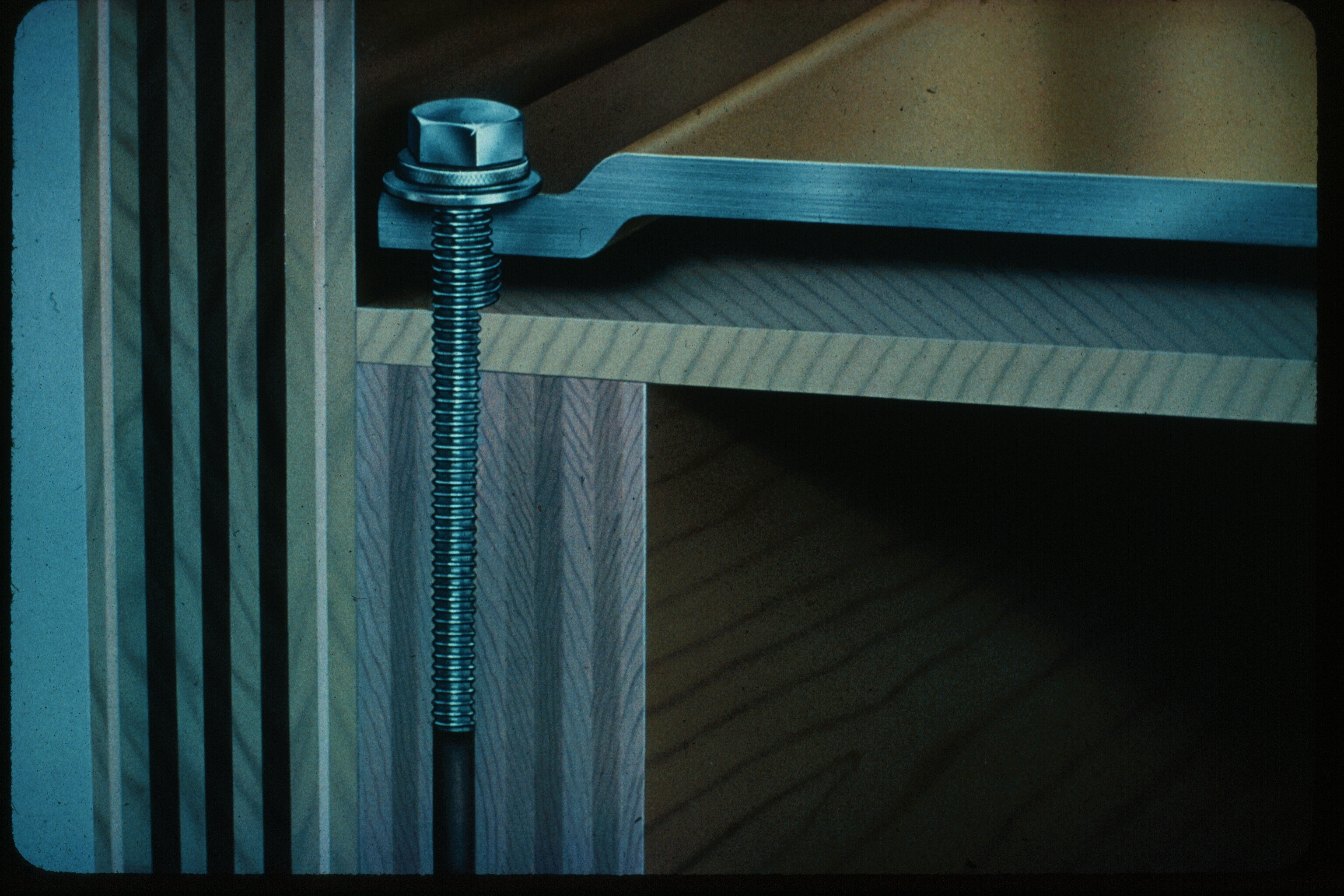

    I have dismantled several grands that turned out to have seriously contorted plates straight out of the factory. Flexed so badly that, had I done it, I would have anticipated breaking the plate. But no damage. There's more wiggle room there than we were led to believe. I will of course correct what I can, but I can't always eliminate all of it.
  • 25.  RE: Restringing Baldwin acu-just with interesting issue
    Posted 11-16-2024 00:27
    Baldwin pinblocks were not glued to the rim structure. It is quite possible to shim blocks as necessary.
    The string frame mounting system is not the same
    Delwin D Fandrich
    Fandrich Piano Company
    Piano Design and Manufacturing Consulting Services -- Worldwide
    6939 Foothill Ct SW -- Olympia, WA 98512 -- USA
    Phone 360.515.0119 -- Mobile 360.388.6525
  • 26.  RE: Restringing Baldwin acu-just with interesting issue
    Posted 11-16-2024 00:30
    To finish --
    Baldwin string frames did not use 'adjustable' mounting bolts as is now common in Chinese (and, probably, Japanese and Indonesian) pianos. We call it the WN&G mounting system because WN&G imports them and sells them here. It's a bit more difficult with Baldwin string frames.
    ddf
