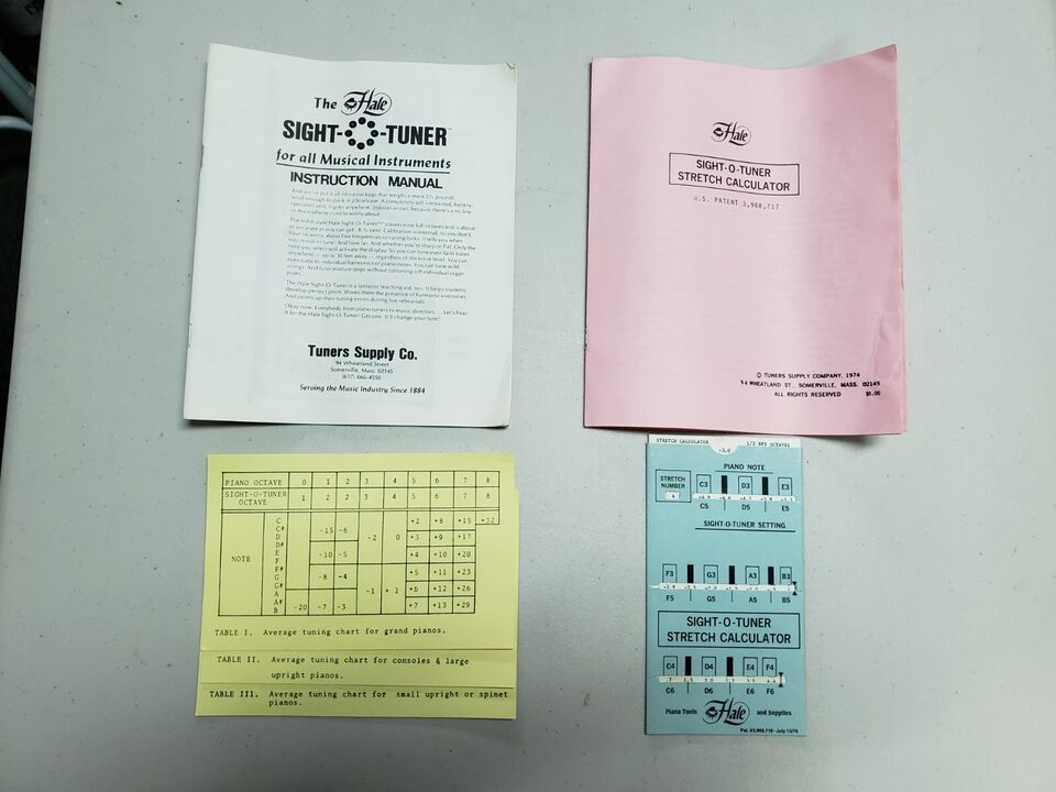

    Update:
    Paul Sanderson sent me a link to a Site-O-Tuner on Ebay with all its original paperwork so I just bought it. I'll follow up once I have a chance to play around with the stretch calculator. Here's some pics:
    Ryan Sowers RPT

  • 10.  RE: Sight-O-Tuner Slide Rule
    Posted 07-01-2023 02:14
    What was common to all of the stretch calculators was 1/2 bps at the 4:2 between A3 and A4. We would now consider this a little to wide.

  • 11.  RE: Sight-O-Tuner Slide Rule
    Posted 07-02-2023 15:48
    Thanks for that Carl - that is interesting. After reading your response I went and checked the width of the A3-A4 octave on the Steinway O in my living room. The way I do it with TuneLab is to set the machine on manual note switching and have it listen to A5 while playing A3 and A4 after stopping the display on each note and noting the Hz reading.
    I could hear just a slight but noticeable difference using the 3rd/10th test that proved my 4:2 octave was wide. My measurements showed that the actual Hz difference was closer to .3 which corroborates your comment that .5 Hz is probably a little too stretchy. I think 1/3  beat wide is probably about the sweet spot in that area of the piano in many cases.
