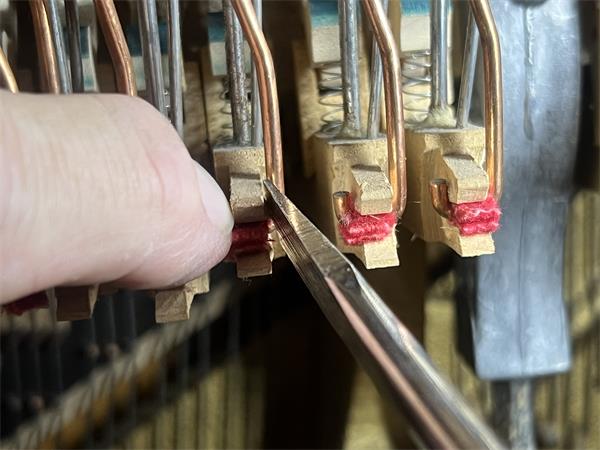

• With the action still in the piano, use a hook to pull the lower hook of the abstract from the fork in the wippen.

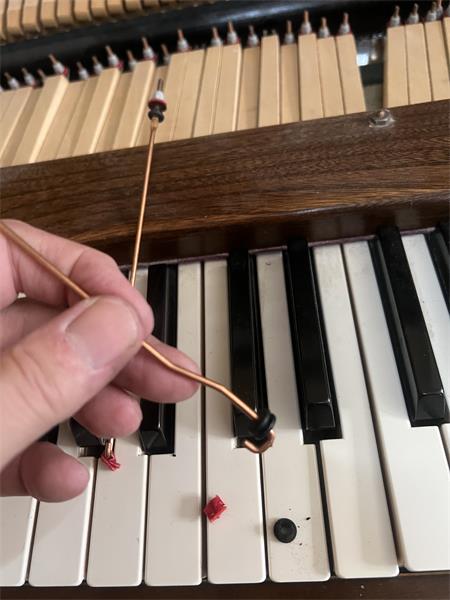

• Remove the abstract, with the grommet in place, from the fork in the keytail.

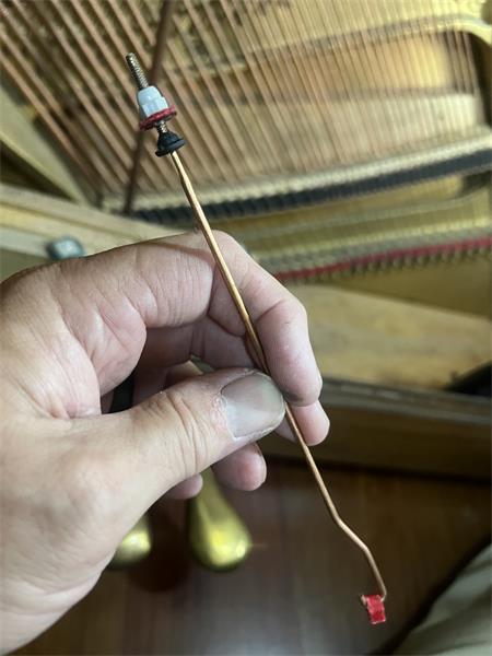

• Slide the bushing loop off the hook then slide the old bushing off.
• Slide on a new bushing on the abstract then slide the bushing loop back onto the hook.
• Place the abstract grommet back into the fork in the keytail.
• Push the bottom hook of the abstract back into the wippen with the glued portion of the loop facing out.

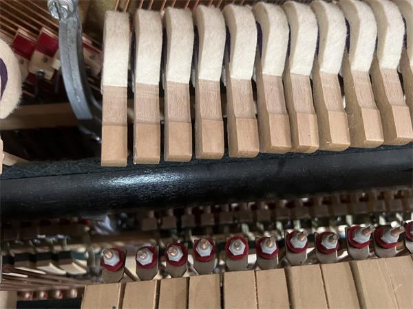

• Adjust lost motion via the nylon nuts on top.
• Elapsed time: approximately 2 hours.
• Do any other work and bill for your time and parts.
• Notes:
- Don't spin the nylon nuts off, especially with a cordless drill/driver since this loosens the threads and introduces regulation stability issues.
