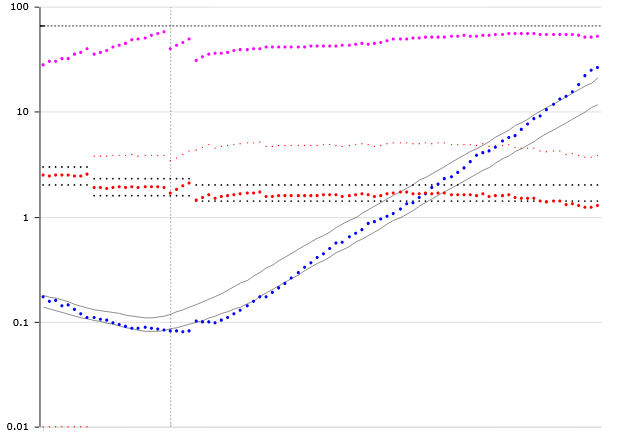

    As to the original question, the attached graph has notes 21 through 24 converted to bichords with existing bridge using .041 core, .0007 copper, and 25mm exposed core at bridge and aggraffe. The core wrap diameters of notes 1 through 20 have also be modified (roughed in and not necessarily final). Notes 1 through 88 left to right. Magenta=Break% Red=Tension Blue=Inharmonicity Light Red=Combined tension.
    New Tensions:
    Note 20 191 lbs per string 382 lbs total (top bass bridge note)
    Note 21 169 lbs per string 338 lbs total (bottom long bridge note)
    Note 22 182 lbs per string 364 lbs total
    Note 23 197 lbs per string 394 lbs total
    Note 24 210 lbs per string 420 lbs total
    Note 25 143 lbs per string 429 lbs total (new lowest plain wire trichord)
    Links to additional before and after examples are available if one replies Privately.
