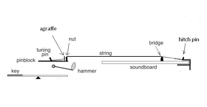

    As you know in a piano the strings, from the agraffes to the pinblock, are not parallel to the floor, they don't go downwards, but they rise upwards (the opposite of violin or a guitar etc), so I wonder why not to try a pinblock lower than the agraffes, changing strings angle like in any other string instrument? Cristofori tried but he didn't use agraffes to stop the vertical blow from the hammers. So what would happen today with agraffe stopping that upwards hammer blow? I see only benefits: 1) No need to worry about lack of downbearing, bridge and strings will always have a good contact, and probably no bridge pins are needed. 2) No need to worry about capo bar. 3) No need to worry about coils number in the tuning pins. 4) No need to worry about the wedge falling from the horn when detuning. So, why has never been done?

    "As you know in a piano the strings, from the agraffes to the pinblock, are not parallel to the floor, they don't go downwards, but they rise upwards (the opposite of violin or a guitar etc),"
    This is your first mistaken assumption. The strings of a piano, between the agraff and the bridge, do rise up, the same as a guitar or violin. That's how the strings get down bearing. There has to be upward pressure on the Vbar and the agraff to maintain the down bearing on the bridge.
    If the pinblock was below the agraff, which would make the strings come out of the bottom of the agraff holes, the strings will literally bounce off the bottom of the hole, creating false beats.

    "This is your first mistaken assumption. The strings of a piano, between the agraff and the bridge, do rise up"
    Hi Wim, I am talking only from agraffe to tunng pins. Not from bridge to agraffe. If the strings are bouncing inside the agraffe hole, I think it depends on the height of the agraffes. In todays piano, do the strings inside the agraffe have any bouncing problem? Do they come off the top of the agraffe in todays pianos? No, so if the tuning pins were lower than agraffes, why do you think the strings can come off the bottom of the agraffe?

    Because the initial contact of the strings is an upwards blow of the hammer, there is a lot more energy in the string to make it bounce off the bottom of the agraff hole.

    The violin has horizontal tuning pegs. The piano has vertical tuning pins. If the tuning pins sat lower than the agraffe, there would be upward pressure on the coil. If you have not worked with piano wire, it is far more rigid than string instruments and would be a disaster as the wire would want to overlap on the coil. As with the observation I made in your post about upbearing, as the piano is designed to not put stress on glue joints, the tuning pin is also designed to have downward pressure which is more stable. Lastly, as Wim pointed out, the hammers put upward pressure on the strings. The string contacts the agraffe at the top of the hole, not the bottom. This stabilizes the string in multiple ways, first the string has nowhere to go when the hammer strikes from underneath. Second, this point of friction allows for slightly higher string tension on the non speaking length between the agraffe and tuning pin, which allows the instrument to hold its pitch after a hard blow and the speaking length increases tension.

    Hpe you can see it. The string, from the nut to the tuning pin, is going downwards, but immediately after the nut, there is the agraffe pulling the string down, so the hammer blow won't cause any problem.

    Why have an agraff?  Why not just have the strong go over the nut?
    If you did have an agraff, and the string needs to go over the nut, it creates another bearing point. or pressure point.
    But in either case, the hammer blow from underneath would make the string jump up off the nut. (On a violin, the string is set in motion with the bow pressing down on the string).

    There is also another possibility, all patent free. In this case the string goes down from the nut to the tuning pin, but between the bridge and the nut there is the agraffe pulling the string down. Here, exaggerating the angles:

    Here you again have two deflections of the string. And you wind up with the string coming out of the agraff on the top, which it does now. So why have the nut?  Just to have the pin block below the level of the strings?  Doesn't make sense.
