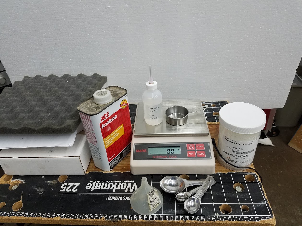

Fear not! I have successfully brought overly steamed high treble hammers back to life with B 72 paraloid. You can mix it with either acetone or ethanol. I prefer ethanol, as it is less toxic.
I carry solutions of 12 to one, six to one and three to one. Erwin Piano's website should offer some details about making good solutions. In addition, there is a video on the PTG website, made by the individual that brought this substance into the piano world, Ken Eschete.

I'm going to try the B72 crystals from Dale Erwin Supply. Can anyone recommend a good recipe for the mixture? Top 6 notes I deadened with the Protek hammer softener are the hammers I need to treat.
