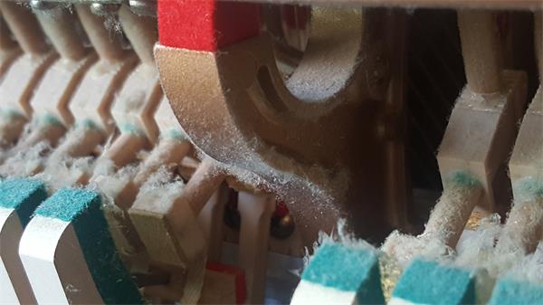

    My guess is probably finely shredded ecsaine from long term backcheck wear, but if it's something I should be more concerned about I thought I would post here and check. More prominent in the middle of the piano than on either the bass or high treble ends.

    That's my guess too.  Seems to be an issue with a certain vintage of Kawai.

    That dust is not from the backchecks, but from the eucaine on the hammer butts, where the jack escapes. The fake leather wears out so much that it needs to be replaced. I've done that a number of times in Hawaii.

    It's mold. I see it all the time on Kawais. I've never seen it on a piano other than a Kawai. I had it tested at our college science department. They told me they couldn't narrow it down to the exact mold without a fruiting body, but it's mold. I can share some pictures of much worse if you'd like. ;-)

    I have never seen this on any piano except for newer pianos with Ecsaine (artificial buckskin).  If this were mold it would appear on other pianos.
    I have taken mycology, mold requires much higher humidity than is found in most pianos.  In environments with high humidity you can occasionally see dusty white patches that might be mold.  I saw a customer's piano recently with black mold under the keybed and other indications of mold, but this piano also had widespread evidence of water damage and badly rusted strings.
    I call it "Ecsaine beards" and as far as I know it is harmless.

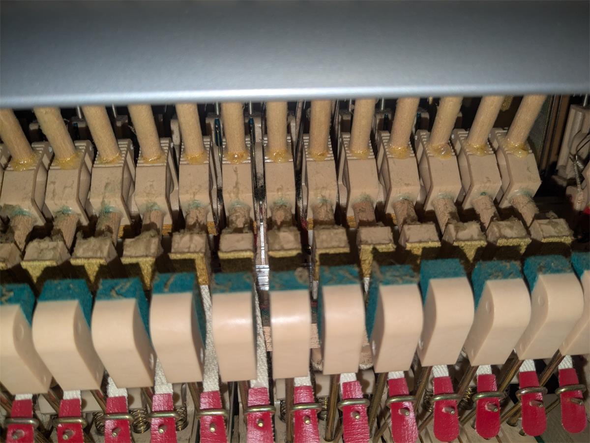

    Speaking of Mold, I had a Samick with something similar that I was told was Mold. See the pictures attached. However, your situation looks more like dry dust where mine was a sort of greasy dust.

    First of all, congratulations to everyone who identified this as a Kawai issue. In my haste I neglected to note that it is a 1989 Kawai CX-5.
    Peter: What did Don have to say?
    Wim: Thanks for the correction. Yes, I meant hammer butts.
    Maggie: Mold? Why would there be more of it in the middle of the piano that gets the most use rather than on the ends? Yes, a picture might help to see how closely it matches with what I'm finding in this piano.
    Follow-up question: What should I do about it? If anything?

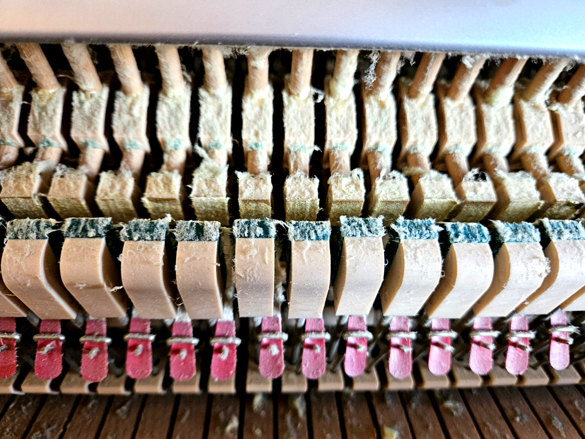

    Look Carefully At The Pictures! (Include Maggies Youtube post.)
    Each one shows something different!
    The Kawai shows dusty threads and thinned out backcheck "buckskin," more worn away in the midrange.
    That is something I have encountered precisely, only on Kawai verticals of a certain vintage.

    Ed et al - Just regarding the first picture from Geoff and my YouTube video, his picture is what mine looked like before it "grew". As for Keith's picture, it may be mold, but a different kind.
    I call this stuff, "flossy mold" and have only seen this particular type on Kawais. The mold I see in other pianos, is typically the green or white, "fuzzy" type. It can get up to 1/8" thick, but tends to stay less than 1/16" thick or splotchy. Black mold in pianos here is much less common but I have seen it a few times and it is never thick...just splotchy. I have a friend in CA who chimed in to tell me she sees mold in pianos there, so it does happen, and she has seen this in Kawais as well (she also believes it to be mold). As far as I know, it's harmless unless one is actually allergic to it. I'm more worried about it degrading piano stuffs. There is an orange type of mycelium here that degrades wood and I have found it in two pianos (one grew two orange mushrooms). I have a batch of the flossy mold and may pay to have it tested by a reputable mold testing company instead of my local college. I really want to know.

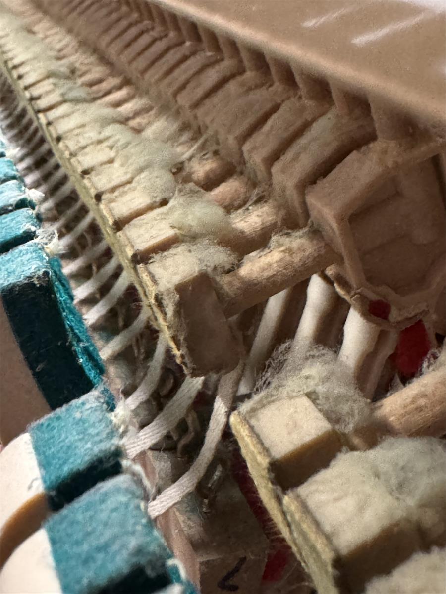

    Just to add one more photo to the mix here... This is a Kawai 602M from the early 90's that I just acquired. It has a similar fuzziness going on. At first glance it doesn't look like mold to me so I was hoping this is an example of the back checks or catchers deteriorating. The closer I look though, the less I'm convinced it's not mold. It's most prominent in the middle octaves, and not at all present in the low bass. The color seems to match the catcher material somewhat, a greenish yellow. It does extend upwards along the hammer shanks in some parts and also a little bit down on the let off buttons. I wonder, if it is mold, then why is it so consistent in its location in all these pianos?

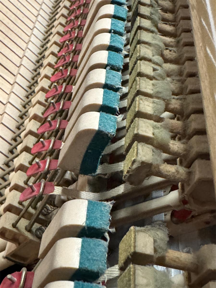

    I came across this during a floor tuning for a piano being sold on consignment at a local retailer. Kawai CL-3.
    I'm inclined to agree with the mold conclusion. I'm wondering if there's been any more testing done on samples since the last entry?

    Since this is only found on pianos with escaine parts it is not mold.  If it were mold it would be found on other pianos besides 1970s consoles.
    Vacuum it up and finish your service call.

  • 36.  RE: What is this dusty stuff on the backchecks?
    Posted 03-16-2025 21:06
    I don't have any skin in the game whether or not it's mold or escaine, but it seems possible to me that this escaine material may be conducive to growing mold. This could also help explain why there is more in the middle- more escaine deteriorated in the area played most which helped grow more mold.
  • 37.  RE: What is this dusty stuff on the backchecks?
    Posted 03-16-2025 21:42
    Why is it not growing mold on music desk Ecsaine?
  • 38.  RE: What is this dusty stuff on the backchecks?
    Posted 03-16-2025 21:52
    Light?
  • 39.  RE: What is this dusty stuff on the backchecks?
    Hi Wim, Steven, & Tim,
    Let me address the age question first. It is happening on new Kawais. Gina Bonfietti has serviced several new Kawais that have it. This brings me to wear...
    In my personal experience, the escaine isn't worn out. Since Gina's pianos are newer, hers isn't worn out either. The escaine is just fine. bit in Gina's and my experience, it's growing in places other than just the escaine. Also in our cases, it really wasn't worse in the middle on most of the pianos. It was across the whole action.
    Wim asked, "But why would this stuff only be on Kawai pianos, and then only on those Kawai's that have escaine? And why would it only be on those Kawai pianos that had very worn out hammer butt jack return "leather", and primarily only in the middle octaves?"
    Answering the second question first, it's NOT only on those pianos that have very worn out anything. As for the first question, I have no idea except that IF it's mold, it must be coming from one of their sources of material (I was assuming wood, but have no real information at all). If it's not mold, then I really have no idea.
    I recently thought I found it on a piano that wasn't a Kawai (I think it was a Boston), then found out Kawai made it.
    Steven said, "Maybe you have more aggressive molds in your neck of the woods."
    We absolutely do. I have always assumed that's why I deal with it more than others. I deal with regular mold more than others. I just had a piano yesterday with fuzzy green mold all over the hammers.
    Steven - These pianos did NOT have dehumidifiers in them. The white attachment has tiny tubes coming out of it to vacuum in small spots or around things you don't want to suck up, such as punchings.
    Tim - In my case it isn't always worse on the escaine, but sure.
    I feel like someone said I may have a double problem of mold AND escaine fluff. Absolutely possible. The thing that gets me is that they typically look a little different, particularly in that the escaine fluff won't turn green...I'm guessing. I just don't believe that stuff on the hammer shanks is escaine fluff.
    The only reason I care if it's mold or not is that it can grow back, and it might not be so good to breathe. Also, IF it's mold, it could be prevented if the source is found. I know that drywall here gets mold spores in it while it sits at the warehouse, so when you put it in your house, instant mold in the walls.
    If anyone can tell me where to send it for more or better testing, please let me know!
    Maggie Jusiel, RPT
    Athens, WV
    (304)952-8615
    mags@timandmaggie.net
  • 40.  RE: What is this dusty stuff on the backchecks?
    Posted 03-16-2025 23:17
    Maggie
    The pianos that I encountered were about 25 - 30 years old.
    If it was mold, then I guess I put my life in jeopardy because I removed and cleaned the parts with bare hands and no mask. So far, though, I feel fine.
  • 41.  RE: What is this dusty stuff on the backchecks?
    Posted 03-17-2025 00:10
    Maggie et al,
    I have contacted local mycologists and I will send out samples and will perform a microscopic analysis on this issue.
    I will write an article for PTJ on this subject and put it to rest.
    For now I suggest that you don't worry as I have not heard of anyone contracting escaine disease from Kawai pianos.
  • 42.  RE: What is this dusty stuff on the backchecks?

    This has been one of the most intriguing threads ever that we have been following. Only thing I can add is that we too have seen this - but ONLY the more milder versions of this where it is only seen in the most played areas of older Kawai uprights here near Nashville Tennessee where it is usually quite more humid than most states.
    Though I believe this material is not true escaine and some other simulated buckskin - or at least it seems to be from certain eras.
    It seems plausible that we are seeing two issues in one action.  I think the simulated buckskin from certain periods seem to deteriorate during use, while at the same time is able to absorb moisture at a rate that is less than ideal in areas that stay moist.  Middle Tennessee stays more humid than most areas in the country, but we do have plenty of dry-out times where the humidity goes way down so it's more oscillating back and forth from humid to dry.  I suspect Areas where little to no dry spells happen is when the mold issues creep into the equation.
    Would be a great journal entry when this all gets sorted out🎹
    This next part should be pretty easy - We would just need to sample from a kawai that has stayed out in the dry desert and played a lot. So as to eliminate the idea of two separate issues that  occur independently.
    Matthew W.
    A.M.O. Pianos
    Lebanon, TN 37087

    I have seen this on Kawai grands, on the knuckles and back checks (possibly even the rep lever cushion that contacts the drop screw.

    I've joined the discussion a bit late. It's mold.
    The newest piano I've seen it on is from 2014. I believe that Kawai changed their action material after that. From what I've noticed, the fuzz develops where the back check and catcher connect, so if the piano is played in the middle, it will start there. In my opinion, a reaction between these two materials triggers the mold, which then spreads. It's not uncommon in our industry to see materials that don't work well together, like Steinways with verdigris and Sohmers with hammer rail return springs.
    Maggie has encountered some severe cases, likely growing in a humid environment for years. I live in Connecticut and have seen it on every Kawai made between 1980 and 2014 that I've serviced. The growth rate might be very slow, showing a few fuzzballs that would go unnoticed if you weren't looking, but once you start observing, you can't unsee it.
    Maggie and I emailed Kawai about this issue. After speaking with the factory, Kawai provided instructions on how to address it. I've cleaned four pianos using Kawai's method. I have tweaked their suggestion and recommend taking action outside, wearing a mask, vacuuming with a bagged vacuum, disposing of the vacuum bag, and blowing out the action with a compressor. Use a paintbrush to apply the Concrobium to the affected areas, and do not spray the action.
    As mentioned, my daughter took samples to her lab, where they were plated on agar, incubated at 25°C, and allowed to grow; the samples grew under the microscope.
    Not everyone reacts to all molds, and mold may not affect everyone, but it can linger in your system and might impact you years later.

    Posted 03-18-2025 11:04
    Gina wrote:
    "From what I've noticed, the fuzz develops where the back check and catcher connect, so if the piano is played in the middle, it will start there. In my opinion, a reaction between these two materials triggers the mold, which then spreads. It's not uncommon in our industry to see materials that don't work well together, like Steinways with verdigris and Sohmers with hammer rail return springs."
    Since I can't help but play armchair detective: Has anybody seen this stuff on other surfaces that use ecsaine, such as knuckles, drop screw contacts on wippens, or hammer butts?  IIUC that does not happen, nor do we see it on other wearable felt/cloth like the hammer rest rail on verticals, bottoms of the wippens, etc..  So that lends even more credence to the idea that there's something special about wool felt/cloth contacting ecsaine.
    IIUC in order to grow, mold needs something to eat, and that something must be organic material.  Ecsaine, at least from what they're telling us (https://www.ecsaine.com/en/about/), is not organic, instead being made from polyester fibres.  Wool of course is organic.  So when the two rub together, perhaps it reacts with or breaks down the wool in a way that makes it especially tasty to mold.
    From a health standpoint, if the stuff grows mold in a petri dish then we should be a bit careful with it when cleaning...  But from a curiosity standpoint, I wonder if it's _all_ mold, or just stringy felt/polyester fuzz that has some mold growing on it?
    Another piece of the puzzle is: where is the mold coming from?  I think this will be the hardest question to answer.  Off the top of my head, it could be embedded in either material but inactive, or it could come from the local environment, or maybe it could even be something that hitched a ride all the way from the Kawai factory(ies).  Do we _only_ see this on Kawais, or has it ever shown up on another make?
