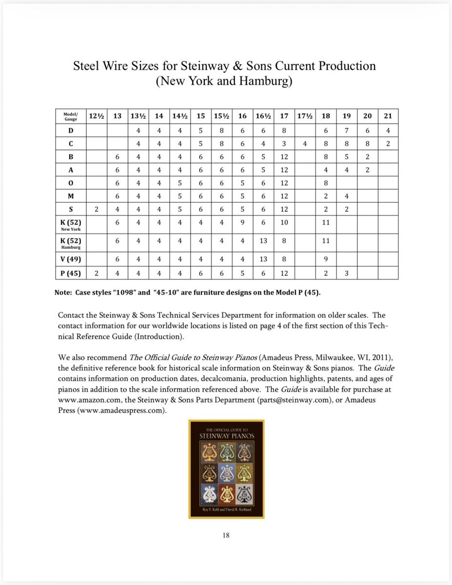

    Hi Tim,
    My favorite method to identify a Steinway really quickly is to count the plate web cooling holes. Unless the piano has 4, you hardly need to look at anything else.
    S-5
    M-6
    O,L, A -4
    B -5
    D-8
    This piano has 6, which makes it functionally a model M
    (I say "functionally" because sometimes the extended case style accommodating the pneumatic player system altered the model name, but this wouldn't affect scaling.)
    I've attached page 18 from Chapter 7 of the World-Wide Technical Reference Guide here which shows the scale you're looking for
    Steinway & Sons World-Wide Technical Reference Guide: Chapter 7 Page 18
    Email me and I'll send you the entire guide
    Daniel DeBiasio

  • 9.  RE: Wonky S&S scaling
    Posted 03-25-2026 10:43
    Two tenor bichords says model M. Proper scale is readily available from Steinway and many other sources.

    Thank you everyone! Daniel, thank you for the info and confirming that the extended case doesn't alter scaling- that was my primary concern since I wouldn't know where to find the scaling info on a non-standard model.
