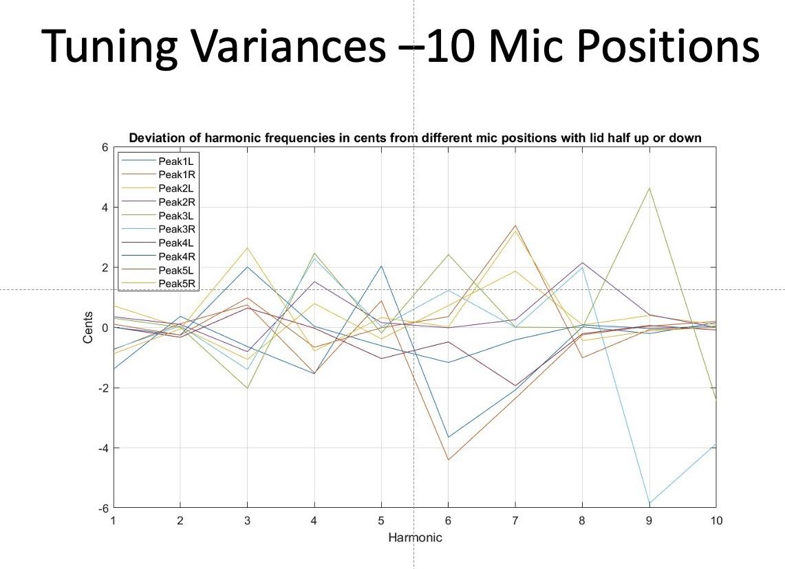

    What started this research? My partner, former MIT prof. and PhD in signal processing, recorded his Steinway B with 10 identical mics on various notes, and used intra-bin interpolated FFT's on the first 1 sec of data (a technique well accepted in the field). He looked as the spatial variance of the first 10 partials. Below is a picture of that result. This further allowed us to look into the basic mechanism. The parallel resonance model or eigemmodes is the best explanation so far. It also validates why aural tuners like Peter can count different beat rates (frequencies) spatially.
    Steve N.
    Spatial Tuning Variations of 10 Mics
