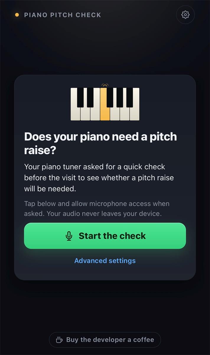

    Hi piano friends, I've made another free piano technician tool! (Open to feedback and feature fixes).
    https://pitchraise.app/index.html
    This web-based app enables customers to be able to check if they need a pitch raise as part of the appointment setting process. This runs in the web browser so any modern phone, iOS or Android can use it.
    There are no downloads, no cost, no ads, no sign up's - send the link to your customer and let them measure the piano themselves. It's pretty simple. If you have pre-set limits on pitch raises (some techs say -10, others say -20, etc) - ask the customer to open the settings and change the pitch field to YOUR value.

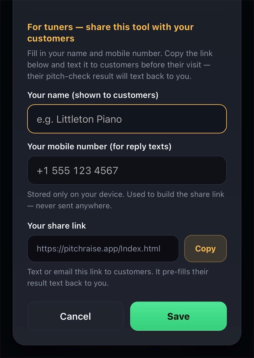

    For tuners - if you enter "0000" in this field a new window will display - you can enter your name or business name and phone number - this generates a link you can copy with a "Deep Link" - when they open the link it will say your name or company, ie. "Denver Piano Service would like you to measure your piano to see if a pitch raise or additional tuning is needed"
    When the customer completes the testing it generates a button to text the results back to you.

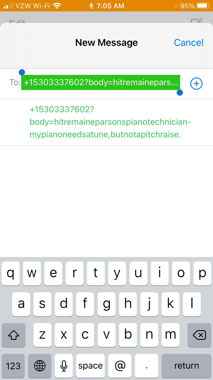

    Sean, I can see now that the link created has the Tech Name and Phone added to the link to be parsed out server side.
    In creating my Tech profile and sending the link to my iPhone, testing my piano, I do not receive a text report. Can you replicate this? I am on an iPhone 6S (I know old - so am I and my tuning lever)
    Also, I'm more likely to buy you a cup of coffee if you have both: a Venmo and PayPal option. (grin)

    It seems like you've uncovered an older iOS thing - The issue is the SMS button (i think)...  iOS uses &body= while Android uses ?body=. The code uses ?body= which works on Android but can fail on older iOS devices. I've updated the page and would love to hear if it resolves or not.

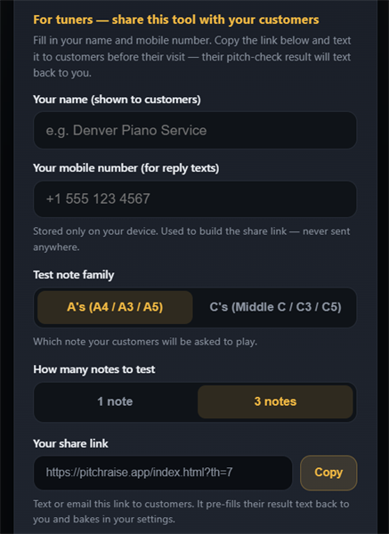

    Firstly, thank you all for your incredible feedback!
    For anyone asking or finding this tool in the future - you can absolutely use it on websites or text it around!!
    • Removed all "pitch raise" messaging from the app, "correction" and "based on this check" are in, adding emphasis on a longer appointment window. The main thing now is the fact that the web URL is literally "pitchraise.app" - it was available 🤷‍♂️. If people are buyin' coffee - i can register a different domain name. I'm personally agnostic on "pitch raise" language.
    • The tuner settings now provide options to choose between C's or A's and one note or three.
    • Updated language on the checking notes process for less-musical folk (with keyboard picture and identified note)
      • A4: "Find a group of THREE black keys near the middle of the piano. Press the white key between the last two black keys of that group."
      • C4: "Find a pair of TWO black keys near the middle of the piano. Press the white key just to the LEFT of those two black keys.

    Looks very good. One small suggestion: Where it says
    To avoid any possible ambiguity, you might say instead, "Press the white key to the right of the middle black key."
    Otherwise, great!

    Wow! Near perfect and I think the middle C and 1 or 3 note options are a huge plus!  I can see a few more minor things which will be coming with a little more time to review. You are at the nuance stage and hopefully without much mission creep.

    Floyd, amazing! Glad you're excited about the tool!
    There are a few more suggestions from above that I'll work out this week

    I have found another virtual keyboard that is globally tunable for beta testing Sean's app. Run on your desktop and test with your device.
    https://papiermusique.fr/en/virtual-piano
    Sean has added more user setup options but I had to refresh my setup page to see the new options. Great work Sean!!

    Floyd,
    I spent some time this afternoon trying to implement this feature as a button for the user - upon further investigation, web browsers don't allow code on a website to close the browser window. I've added language at the end page that reads "you may now close this window" -- I'm  not sure if customer's will read it, but we can iterate on the idea.
    As Tremaine noted - if you refresh your browser this page was on, there are new features like adding/removing language to specifically address appointment timing, as well as including approximate recorded cents deviation in the return text.
    There is now also a customer-facing FAQ in which I try to hardest to push "SCHEDULE A TUNING!!" on every answer -- as well as a separate tuner FAQ where the app is explained in more context and I offer additional services.
    I appreciate everyone's help and suggestions on making this come together.

    Today I had my fist customer reply to a pitch check request. I have wondered how willing clients are to participate.
    I asked Sean to bring back the cents deviation within the text report and I am very glad that he brought it back as an option. Sean mentioned that someone said that the reported deviation was not accurate. I would not expect it to be accurate but approximate. I did a quick test today and using cents deviation turned on and the app reported that Middle C was 38 cents flat when it was 41 on my Verituner. Another report said 30 cents flat when Verituner said 36 cents flat. These numbers are close enough for me to get a ballbark of the piano pitch level. I believe that, as the app is grabbing the pitches of 1 or 3 notes, it is likely using an average railsback curve as an approximation by which to measure pitches to take Inharmonicity into consideration. If this is the case than we can assume that all the measurements are approximate. As far as I am concerned, approximate is fine. That's all I need.

    So amazing you've got it in customer hands, Tremaine - I've added it to gazelle and am not tracking engagement with it yet, looking for evidence as a hands-off conversion tool.
    Interesting tidbit: I showed this to a mover who sees more pianos that I do on a daily basis (and picks up a lot of cheap/freebies and flips them) - he's excited to have his own glimpse into a piano he didn't have before.
