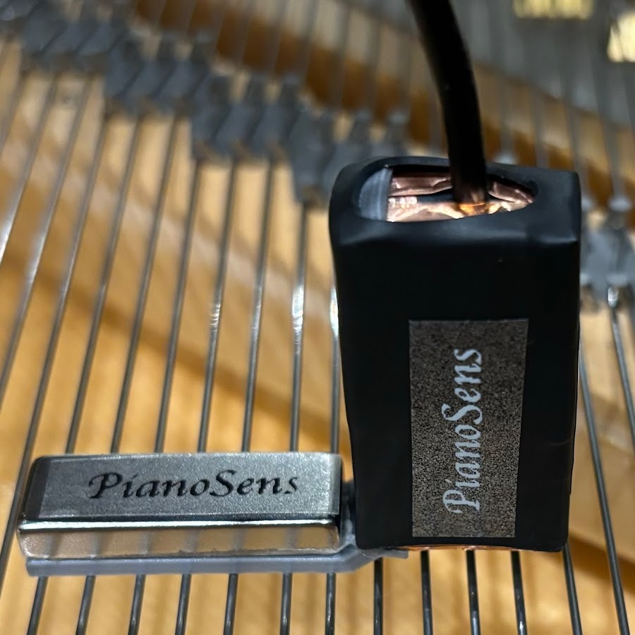

    I appreciate the ART and the SCIENCE of this. I have had lots of off-line discussions with great aural tuners and several have resisted the ETD ideas because they know how varying the results are with acoustic interference affecting the ETD's inability to resolve the harmonics accurately. So many have decided to stay with aural tuning and treat it as more of an art. I DO appreciate that! My first point of reference is 'music' and the art of it. I think the above statement by me will 'surprise' many. My first 2 degrees were in music, not engineering. Then my next 2 degrees were in engineering. It tells you where my 'heart is' at the 'emotional level. Surprised? LOL!
    NOW, as some of you are aware of my initiative to research a reliable and invariant way of making it more of a science, I liken this to Gary Kasparov, the world's last greatest chess player. Chess is part art and part science (mathematics and statistical probabilities). He cannot beat an iPhone-based chess program today! The last time he could beat IBM's Deep Blue supercomputer was in the early days, before the year 2006.
    We will always need good mechanically skilled people to do regulation, string leveling, hammer voicing. We will always need great ears to compromise badly mismatched bass bichords with huge differences in their IH character.
    What if we could come up with an invariant and dependable way of taking a piano that is in 'good shape' in these ways, and then create our 'art' by selecting the temperament of our artistic choice, and then sampling the notes to set up that temperament wherein the sampled notes are 'frequency accurate' with 0.1 cents relative to one another? That would be an improvement for us, correct? We could then use that same invariant system to know we could nail the unisons string by string to within 0.1 cents, confirming with our golden ears that they do sound super clear like we cannot get by ear-string-matching manually, and, 'yes' knowing they will drift over time and temperature and humidity, but knowing that we start with virtually no error so that after the drifting the error will be far less than if we had started with a larger error which is what we have today? Would not that be extremely 'welcome news' to us? It certainly should be. Start with minimal error and the drift will proceed with less error outcome! Great! The tuning will last longer and the customer will be happier for a longer period of time. A true improvement that is measurable and objective.
    Let's all be honest with ourselves and ask, "If our customers (piano owners) and our peers all think that our 'current methods' are so great and that we are creating great art and we all are satisfied, shall we stop and say that 'good enough is good enough'?"
    Then the next question is this: "Have we ever really objectively measured our work by a professional 'test and measurement system' and does such a system even exist in the PTG?"
    Then the next question is: "Can any of us who are satisfied with our current work ever really be the best judge of ourselves?"
    A major fundamental improvement to today's methodology is coming. It will be more objective and invariant. It will improve our 'art' and it will not obsolete us, but will make us better. This is possible within the next year or less, maybe even today.
    It will require better ‘pickup technology’ and better algorithms within the ETD’s. We need both. We are currently using hardware that is either all-analog and 50 years old, or using ETD’s that have 20-year-old DSP algorithms that have not been updated with major advances that have come out of the 5G and DoD signal processing profession. It has been presented to us as, "Trust me, it is accurate and state-of-the-art," but how can we know that? Do we have any way of verifying that objectively? We have no test and measurement method to verify it. So the outcome is ‘subjective’ and therefore we are back to ‘pure art’. I am not here to turn off any of the hard work that has gone into either the aural tuning art, or the ETD apps. Far from it. These steps were all necessary. But we need to go forward. We need a jury of our peers to evaluate our own work.
    This type of mental and technological 'shift' would not threaten anyone, would not do anything but to improve the artistry of the piano art in which you are proudly part.

    Steven asked: "Then the next question is this: "Have we ever really objectively measured our work by a professional 'test and measurement system' and does such a system even exist in the PTG?""
    While it can probably be improved upon, you may find taking the PTG tuning exam to be an enlightening experience.
  • 12.  RE: Getting back to basics
    Posted 01-30-2024 11:54
    Hi Patrick,
    Obviously I’m interested in going beyond what humans can perceive as a standard because what humans perceive is very subjective from human to human. We need to measure ourselves by an invariant measurement means that’s better than human-to-human variance, and mic-placement variance that has 1 cent changes when we move the mic.
    Best regards,
    Steve
  • 13.  RE: Getting back to basics
    Posted 01-30-2024 12:14
    Steven
    Perhaps you should familiarize yourself with the PTG tuning exam. Not just what’s involved with taking it, but also the preparation and measuring of what we call the Master Tuning.
  • 14.  RE: Getting back to basics
    Posted 01-30-2024 12:26
    The PTG exam has been well described to me in detail. Remember, I’m a research scientist, as well as a musician. I’m interested in the research of going beyond the variability of human to human. There are many stories about how the exam judges hear differently themselves. This all needs to be revised by a higher standard in 'invariance.' We do not have that. We can get there. I am not just satisfied with the status quo. So far I would have to conclude that most PTG members 'are' satisfied with the status quo. Let's go back to chess playing and not make a better chess program that beat Gary Kasparov.
    Best regards,
    Steve.

    I am only interested in applying better technology to raise the bar to a standard that goes beyond human perception. Let me tell a story. I was at NAMM this weekend. I did a live demo for the CEO and head tech of a piano maker. I presented unison tuning string by string with my new invention / device. The head tech could not achieve the same results by ear, and he is very good already! They agreed that while the human cannot dial it in by ear, the human ear can HEAR the difference in the result by the new device.
    I document this in my class I teach. I play live recordings with spreads that are well within the tuning exam. Then I play recordings where they are dialed in better than that. It IS audible, easily so. But we can't dial it in with our ear. Not the best ear. I am not appealing to the top 0.01% of the golden ears. We cannot clone them. I can use new technology to help a junior tuner outperform the best 0.01% tuner. This I document with many examples. This is what I am interested in.
    Best regards,
    Steve
    Steven Norsworthy
    Cardiff By The Sea CA
    (619) 964-0101

    Until you hear it and until you see my class presentation and until you try it you will not know. It IS audible, and CAN hear the difference. But you can't dial it in with your ear or with the current ETD's. Re-read my story with the CEO of the piano maker. This is my last reply on this to you, but you can reach out to me privately and you can attend one of my upcoming classes, as I encourage you to hear my presentation. I have 100% so far every time, the people get it.
  • 19.  RE: Getting back to basics
    Posted 01-30-2024 15:46
    "and CAN hear the difference. But you CANNOT get it with your ear."
    You're saying two things that are complete opposite. First you say I CAN hear the difference. Then you say you CANNOT hear the difference with your ear. So which is it?
  • 20.  RE: Getting back to basics
    Posted 01-30-2024 15:52
    Re-read my story. You cannot dial it in by ear to 0.1 cent, barely 0.5 cents. But can hear the difference result when you dial it to 0.1 by machine. Look my friend, I am a logical guy, consistent in logic. If you really want to know more, you may contact me privately and attend my classes. Many are coming up. No one accuses me of inconsistency in logic. It is not my nature. But people DO often read in what they want to read in.

    I think I might be able to shed a little light on the matter. What Steve is saying is that you (i.e. you, me, him, or anyone else) cannot "tune" to this degree of consonance (i.e. a unison), because our resolution ability is not physically capable of bringing the three strings together to the point of .1 cent, nor do any of the current ETD's as currently set up, accomplish that.
    Steve is saying that when you get it there "you can hear it" (as yet I have not heard this phenomenon). The problem in getting it there is that current tech can't get it there, and neither can we with our ears alone.  When we tune a unison we have the help of the bridge coupling to bring it together and it generally does so at a point outside of .1 cent, therefore, although we have a "clean" unison, we cannot deduce any further "tightness" (if you will) beyond about .4 cent, and neither can the ETD because it's "accuracy" is dependent on a signal coming to its microphone that already has "noise" in it from the time of impact to the time it reaches the microphone. This compromises its resolution capacity to not much better than our ears (if at all).
    His claim (as you know) is that his device sidesteps the inherent the "noise" problem and records the actual string vibrations and nothing else. So it is a truly clean signal going to the ETD. This (he is claiming) is a significant step forward in accuracy for both ETD's and possibly even for ears (we shall see). An ETD with this device would be better able to accomplish this unison tightness.
    I am simplifying to the point that even I understand. It may not be perfectly accurate but I am putting into my own words as I understand it. Hopefully this helps your understanding.

    Great reply. We know things drift quickly with playing the piano, as I tune my own piano and after 3 hours of practice, no matter how good the pin-setting technique is, things drift, even with perfect environment constants. Tensions move around from playing. The problem is that in my experience, most tuners are not coming back and checking their work the next day after their pianist/customer has practiced for a day.
    Now said, let's go to statistics. If the std. deviation of the spread starts out at 0.2 cents, and from playing it winds up a few days later at 0.8 cents, we have increased the std. deviation by a factor of 0.8 / 0.2 = 4X. Now let's say you finish your tune using a standard ETD and now you are starting out at 0.8 std. deviation, and then a few days later you have a 4X change, then you have 3.2 cents std. deviation and the customer says, "I don't like the way it sounds now." Maybe the fussy math retort is that things don't increase by 4X so let's say just 2X from 0.8. That is 1.6, and is audible, and annoying. This is exactly what I experienced as a pianist using RPT tuners, very good RPT's I shall say. I aggravated them because I would call them a few days later and say the piano does not sound good. Seriously. So I am now with the inventions and my tunings last much longer. The most discerning pianists will hear the lack of clarity in the attacks at this much deviation. Why do you think Glenn Gould had his full time tech with him daily?
    I have another story. Paul McCloud has tuned with my device now for over 200 pianos. He is my beta tester. He has a professional pianist with a good Steinway B. She did not know Paul was using a new device but she was shocked at how much better her piano sounded, so much clearer and cleaner. She told Paul that she could not stop playing it was so good! SO... the difference IS audible.
    I had this whole argument that lasted over an hour with one of the VP's of the PTG. I had to tell them that this is about 'invariance' and it is statistical. I think they finally understood. "Start with less error and your tuning will last longer." That is the real essence, Wim. But, Wim, you need to go to my device's YouTube channel and watch the videos. They are all backed up logically with data. I don't believe in 'opinions' but believe in real data to back up things. I do my best in that way.
    Kindly and respectfully to all,
    Steve

    Jason Kanter has provided us with an aural test for hearing unisons in .5 cent intervals. Guess I'm just lucky but I did mange to hit the perfect unison on all but one.
    (the password is your favorite guild that starts with a "p")
    https://360.articulate.com/review/content/ab33a675-b1fa-4933-bc4c-f220a29734fc/review
  • 32.  RE: Getting back to basics
    Posted 01-30-2024 22:04
    Talk to Paul McCloud who has tuned 200 pianos with it. Ask him.
    Talk to Kent Swafford. He just received it and is using it.
    Talk to the CEO of Mason & Hamlin and ask him what he and his head tech heard.
    Talk to Randall Woltz and ask him what he heard.
    I will just say that unless you talk to the people who are using it and have heard it, you have to take this into account.
    Come to my zoom classes. Many scheduled. If interested, I can ask one of the upcoming PTG groups if you may join.
    Of course, to to the YouTube channel.
    Steve

    Paul,
    Do you know if PianoSens works with an AccuTuner? I seem to recall the the AccuTuner uses some analog processing but that may be regarding earlier models The PianoSens web site intro video says that the sensor sends signal to a preamp and analog to digital converter which is then sent to the ETD.
    Have you tried it with an AccuTuner? Actually, now I'm thinking probably not.

    Hi Tremaine:
    Yes, I have tried using PIanosens with my Accutuner.  I used the Mag input with an XLR to 1/8" plug adapter.  It did work, but I had to be very careful to put the sensor directly over each individual string.  The sensor needs a little bit of boost, so it would have been better to use the iRig preamp.  The iRig is well suited to the sensor's impedance, though you could use any preamp.  There is another input jack on the back of the Accutuner which is the Audio jack.  It's an RCA jack, and it is much more suited for an amplified signal.  To use the Audio jack, you have to put a dummy plug in the Mag input (and not shorted).  This is not in the manual as far as I know.  The iRig has a headphone out, and there is a volume control also.  If you use the Mag input, just turn down the volume so it doesn't overload the input.  With the Audio input, you can turn up the volume and it won't hurt the unit.
    The iRig requires power from your iOS device or Android.  So you'll need to have that connection.  I have also used a DR40 recorder, which has XLR connectors for the sensor and headphone out to connect to the Accutuner.  It also has volume controls, so it works well on either the Mag or Audio inputs.  It's interesting to plug headphones into the preamp and listen to the sound of the sensor, as compared to a mic.  It's much more pristine and clear.

    Hi David,
    I’m looking forward to seeing you on the zoom call next week.
    I don’t mind answering questions that have to do with how the device performs and the data behind it. What I don’t like are endless philosophical debates with people because those kind of arguments go absolutely nowhere!
    Best regards,
    Steve

    Norman,
    There are hot and cold spots all over space that are frequency dependent and spacially dependent. Not so for the string. The source is the string.
    Mic position-to-position variance will utterly destroy the proposed test. My research data shows this. There is ample prior art research that attests to the issue. You cannot ‘resolve’ the center frequency of the partials in an invariant manner to within this level of accuracy with this kind of variance.
     Everyone I talk to in the PTG seems to be unaware of the research on nonlinear spring behavior and how it is seen in the piano string. The research clearly shows the behavior we can easily see in the ETD, that the frequency decays (lowers) as the amplitude exponentially decays. That is why I created the Freeze Frame tuning concept, which Pianoscope implemented. There must be a pre-selected window of time at which we send the time domain samples to the frequency analysis. This must be consistently done, otherwise you will have 0.5 cents per second frequency decay or more, and after 1 sec you can have a higher rate of frequency decay. I will be covering and citing this prior art research in my next class.
    Steve
