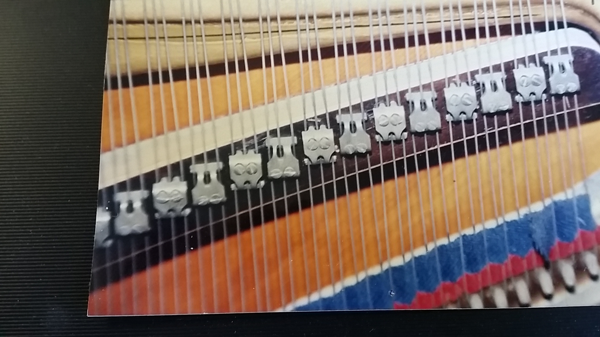

    This Sohmer Grand with a player mechanism has a bridge system to enhance an old "out of tune" player sound, with unisons barking like a honky-tonk saloon piano. It is impossible to achieve clear, crisp unisons. False beats on steroids! My customer loves the sound, and that's what counts.

    I've always thought that this would be a much more efficient way terminate strings at the bridge. Pretty much guarantees that all the strings are the same length, making unisons easier to pull in, and could possibly eliminate false beating strings due to bridge pin problems. You're telling me that it won't? (-sigh-)
    I've come across one model of S&S piano, probably older ones, where the bridge pins aren't anywhere close to providing a uniform string length termination point. Unisons are impossible and I was told that this was a deliberate design to create a piano that would project more. True? False?
  • 3.  RE: Piano tuning perfectionist nightmare
    Posted 09-17-2022 14:17

    Larry ... are those things considered to be bridge agraffes ? I read about them recently not sure where.

    Mine was from 1918. Phoenix piano uses something similar.

    The Sohmer was built in 1922

    Spent the last hour re-perusing the Kehl-Kirkland masterpiece Official Guide to Steinway Pianos.  It threatened to frustrate me as much as David ever did (nevertheless sorry he's no longer at Steinway), but persistence was rewarded.  The first mention of "unequal speaking lengths" is with regard to the Model C (Old curve) (Style 3 - 7 1/4 octaves) 1886 - 1892  - on lower treble section.  However, on pg. 179 (last paragraph) they point to the 1884 D as the original model depolying unequal lenghs, though in differing sections: D had them in upper center and lower treble, while C had them only in lower treble.  On  page 195, in discussing the modern D: "In the 1930's, unequal speaking legths in the lower-treble section were superseded by equal speaking lenghts."
    No wonder he always seemed distracted.  A belated thank you.

    Did any of the articles mention why they chose to do that? Was it deliberate or did they make a long running mistake and then cover it up by saying they meant to do that? And then the obvious follow-up question would be, why did they revert back to equal speaking lengths?

    It was explained to me by multiple different people when I was at Steinway that the purpose was to avoid the coupling effect and thus increase the projection and sustain in that part of the scale. Just for what it"s worth I have never had a problem turning unisons on notes with the bridge in that configuration. I think the effect of the slightly unequal speaking lengths is greatly exaggerated in the minds of most technicians.
    I have only experienced this two, maybe three times, and they were very frustrating experiences. Each  time, when I took a look at the bridge and found that it incorporated this design, I pretty much gave up trying to achieve acceptable unisons and went with good enough.
    This may be a question for a new thread, but here goes, anyway. The reason for multiple strings in a piano is the increase in power. Acoustically, that means loudness. When you add a second string to a note, and that string is in unison with the original string, you have effectively doubled the power of that note and increased the loudness by 3db. Adding a third string, and having it in unison with the other two, adds half again as much power, or an additional 1-1/2db. Therefore, three strings, in unison, is theoretically providing an increase in loudness of 4-1/2db over a single string. If the unison is out then certain partials start do phase cancel each other out, decreasing power and loudness at those frequencies. If the unison gets far enough out then it starts to create beats. I'm not challenging Steinways methods, I'm just trying to understand how creating beats and decreasing power provides for increased projection. I know several notable techs that deliberately aim for this inaccuracy in their concert tunings for that exact reason, so there's probably something there. Why does this work?

    I should probably leave this one alone and wait for the smart folks to weigh in. However since it's Sunday and I am (shockingly) not working I just can't help myself. My understanding has been that the deliberate uncoupling of the strings of the unisons in the fifth and sixth octaves is to eliminate the drop in power caused by the coupling effect. The beats caused by the +- 1mm difference in speaking length aren't going to be audible at the fundamental or second partial. If a tuner is listening to any sound higher in the partial spectrum (on a Steinway) than that when tuning a unison they are not likely to get a good result.
      One of the most important moments in my career came in 1991 during my first week at Steinway. I was tuning in the Lincoln room just off of the main C&A room in the basement of the old Steinway Hall on 57th Street in Manhattan. As was the custom with all new hires in the C&A department I was tuning the C&A stock pianos one after another so Franz Mohr and Ron Coners could determine what my abilities were as a tuner. Ron was working with me and said that while my temperment, octaves and stability were good there was something just a little off about my unisons. I pointed out a note in the 3rd octave that was driving me nuts because there was a loud beat happening at the 5th partial. When I succeeded in explaining what the 5th partial was and he realized what I was listening to he looked genuinely shocked. After shaking his head in amazement he looked at me and said "That's why your unisons are are off. You have to ignore all those sounds."
      It took about a month to re-train my ears and probably another several months before I truly heard the sound of a unison coming from the soundboard through the string noise. Once I heard it my understanding of tuning fundamentally (see what I did there?) changed. Yamaha's great concert technician Ace Ugai has spoken about "tuning in the sonority" to a number of technicians I know and I have long suspected that he's talking about the same thing.
      I last saw Ron Coners a couple of years ago at the factory shortly before he retired. He reminded me all those years later how remarkable it was that when I first got to Steinway I was trying to tune listening to all the string noise. We had a good laugh about it.

    The aim is not to "create beats". The aim is to "start a beat"  but not complete the cycle. One therefore tries to harness the increase in amplitude of a low partial beat, but the intrainment (coupling) of the bridge "forces" it into unison before it becomes a "beat". At least that's what I try to do.
    Contrary to popular belief, a "dead on" perfect unison (usually) does not sustain as well as one with ever so slightly different frequencies. So the bias cut bridge was a way of "forcing" that inequality. Granted, many tuners didn't like it. Plus, if a competitor tended to point to it and refer to it as "a way to compensate for a defect", you can be sure that a manufacturer would delete that pretty quickly.
    There is a very interesting Bechstein video on YouTube that discusses this whole topic. The gist of it being that there seems to be a background quality to the sound on a bias cut bridge that creates a beauty that is otherwise missing. At least that's what I got from it.
    Finally, I suspect that it is physically challenging to cut the bridge that way accurately...lots of skill needed. If the person who did it died or retired and no one else had the skill to take his place...that would end it quick too.

    One might say that a "dead on" unison is a dead unison. The tone sort of loses color. This reminds me of a piece of wisdom I heard in a ceramics class, as we were learning to center and throw pots on a wheel. "A perfect pot is a dead pot."??
    At Banff I saw a 9 foot Heintzman with a similar bridge, giving a slight variety of speaking lengths.
    If the same idea keeps coming back over and over again in different brands of concert level pianos, one suspects there is some benefit to shaping a bridge like this, even if a lot of tuners don't like it.??

  • 19.  RE: Piano tuning perfectionist nightmare
    Posted 09-19-2022 13:05
    Ed - thanks
    That lecture is interesting but doesn't actually explain the whole story ;-)
     Although I can hear a few places where unisons aren't as laser-like as I'd advocate https://youtu.be/6SPqHBWGMbE?t=2637 might sound different to normal tuning and in particular is there a noticeable calm, a stillness, to the sound? The different tuning concept allows the pianist to extend sustain technique.
  • 20.  RE: Piano tuning perfectionist nightmare
    Posted 09-19-2022 18:54
    So...my experience has been that whenever this subject is discussed ("perfect" vs "imperfect" unisons), ALWAYS it gets misconstrued as advocating sloppiness, when in fact this far from the case.
    Everyone here knows that when you tune any unison as "dead on perfect" as you can, and then take one our super-micro-accurate ETD's and measure the actual frequencies of the individual strings, they are NEVER exactly the same. Then, using the ETD to tune each individual string to EXACTLY the same frequency and play the unison it often does not sound "as good" to us as when we tuned it without the ETD. This is an interesting phenomenon.
    This brings up the obvious question: "What constitutes a 'perfect dead on' unison"? And relatedly: "What constitutes 'mis-tuning'?"
    Virgil Smith never advocated introducing "beats" into unisons. He did however advocate not tuning what is commonly referred to as "dead on perfect" unisons. Moat of us highly respected his viewpoint on things (although not necessarily in total agreement) but he certainly had the fruitage to prove his standpoint.
    Just as there is latitude in choosing octave widths in one's tuning scheme, there is also latitude in "tuning" unisons (believe it or not). Of course our "training" focuses on "dead on perfect unisons", but just as Virgil eventually found that he could "color" the sound as he tuned the unisons (without creating beats) so can we. I'll tell you that it took me over a year and a half to be able to consistently do this (cuz it ain't easy) after reading and assimilating Virgil's 'Superior Techniques" book, but there is digestible food in there.
    Orman Pratt, who mentored me, Rick Butler,  and others, had the skill to tune the most PERFECT unisons I ever heard. He taught me his method which I used for years. However, when I would play a piano he had just tuned, of course everything was "perfect"...but I found myself literally becoming anxious and uncomfortable as I was playing. It took me quite some time to figure out that the problem was that it was just "too perfect"...that was the problem. My musical ear wanted something to "happen" after playing a note...and nothing was happening. It just stood still, and those notes that sounded like they were "about to do something" were pulled in to stillness by the bridge so quickly that they didn't "do anything", and that phenomenon bothered me more than the notes that actually "did nothing". So...technically perfect, but musically wanting somehow. I still always admired his ability to tune the thing so "perfect".  (And BTW, it was ODP that supplied me with the Weinrich articles early on...yes entrainment/coupling is a "thing" that happens, but we can use this fact to advantage, which is what I believe Virgil Smith was trying to say but did not actually know how to elaborate on it).
    Okay so now that I've said all this stuff I'm sure I'm going to get some flack. But go ahead.  I can take it.
  • 21.  RE: Piano tuning perfectionist nightmare
    Posted 09-19-2022 20:19
    Jim Busby discusses the phenomenon of starting a beat but not finishing it in one of his ebooks, I believe it's the one on voicing.
