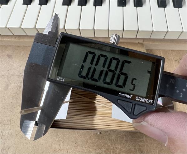

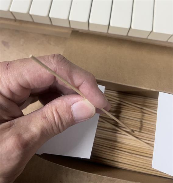

    My cord of preference is white spring cord that Pianotek (RIP) carried since I knew it was not going to stretch. After that my preference is thin .5mm whipping twine (also won't stretch).
    For the wooden plugs, I tend to stay away from toothpicks because the are usually waxed so the glue doesn't stick as well (I only use a tiny amount of glue to install). Depending on the type of plug used originally, I use either shoe pegs (like Schaff 6050) or what Pianotek used to sell as Bridge Repair Dowels. They're actually .085" applicator sticks and I've found that size used in a surprising number of old square and grand actions. Besides, they have tons of other uses in the shop, can be shaped to the job, and are dirt cheap. Pictures below so you can look up a source.
    Applicator stick
    Applicator stick box
    Applicator stick measurement
