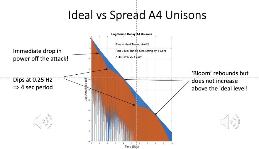

  • 9.  RE: Tune with a Single Partial or Multiple Partials? An Example...
    Posted 02-14-2024 23:34
    Don,
    See attached graph. You are speaking psycho-acoustically as I explain below. Let's respect two schools of thought on this subject. I respect yours and I ask the same for many of your colleges who take the other side of the argument that lines up with the data measurements I have been making. My arguments have measured data with both power and sustain.
    Only measurements and not psycho-acoustics are a good argument or measure. Below shows a spread unison vs non spread one. It is a psycho-acoustic phenomenon you are talking about, not the physical reality. The sustain is BETTER as well as the attack when you make the measurement, but the brain may say otherwise because you are measuring sustain from the 180 degree phase dips that are occurring from the beat frequency of the spread. The law of conversation of energy refutes your argument also. Play the chords in musical context and you will see that the power is in the attack phase.
    Kindly and respectfully,
    Steve
    Spread vs NonSpread
    Steven Norsworthy
    Cardiff By The Sea CA
    (619) 964-0101
  • 10.  RE: Tune with a Single Partial or Multiple Partials? An Example...
    Posted 02-15-2024 00:34
    The graph here shows a detune of 1c, which I think anyone will agree is way too much. Have you tried it with much smaller detuned? IIUC that's what Don is suggesting.
    Nathan Monteleone RPT
    Fort Worth TX
    (817) 675-9494
    nbmont@gmail.com
  • 11.  RE: Tune with a Single Partial or Multiple Partials? An Example...
    Posted 02-15-2024 00:45
    I have tried from 0.1 to 1. It is all scaled. The de-tuned never comes all the way back to the blue line of power. Impossible, violates the laws of physics.
    Steven Norsworthy
    (619) 964-0101

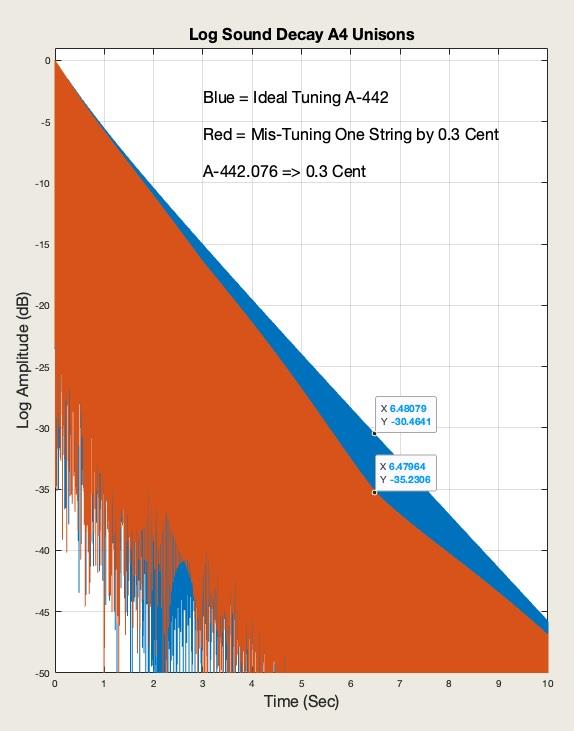

  • 15.  RE: Tune with a Single Partial or Multiple Partials? An Example...
    Posted 02-15-2024 01:04
    Don, you also asked for a tighter spread. I showed 1 cent graph and now here is the 0.3 cent spread graph.
    After 6 seconds, there is a 5 dB LESS SUSTAIN. Physics are Physics, but Psycho-Acoustics are also Psycho-Acoustics.
    See figure below.
    Steve
    0.3 Cent Spread in Unisons and LESS sustain by 5 dB after 6 secs
    See figure below.
    Steve
    Steven Norsworthy
    (619) 964-0101

    Linda, see my new reply to Don on item number 13. I will repeat it again below here...
    See figure below.
    Steve
    Spread by 0.3 cents with 5dB LESS sustain

    1. Zero-cents tune the unisons across the entire piano, then
    2. Go play the piano for 3 hours of practice including very dynamic piano literature, then
    3. Go back an hour after that and check the unisons and record how much they drifted from zero cents, and then
    4. Spread-tune them to your subjective liking and not to zero, and record the spread, then
    5. Go play the piano for 3 hours of practice including the same dynamic piano literature, then
    6. Go back an hour later and check the unisons and record how much they drifted from you spread-tuning, then
    7. Compare, and publish the result to the PTG forum and that will be very interesting to all.
    8. Did the spread from lots of playing hold up to your liking more than the spread from zero-cents tuning? That is a subjective determination but all should see the numbers.
    Steve N.

    Here is Steve's latest video rebutting the idea that there is no decay of frequency over time:
    https://www.youtube.com/watch?v=bohjZwy6JNM
    Using a concert grand piano, and using Matlab-based frequency analysis and the best-known inter-bin interpolation, the pitch of the note C2 drops 1.8 cents in 1.5 sec after the attack, and drops a total of 3.2 cents 3 sec after the attack. I was challenged by the assertion that the pitch does not drop after 0.5 sec. This is proof to the contrary. It all has to do with the nonlinearity of the piano string. Frequency decay along with amplitude decay is a known phenomenon in 'spring theory.'
    Name the piece in the piano literature that has a long single-note non-pedal sustain with no other notes. That piece does not exist unless John Cage wrote it! It is totally academic to tune that way. It results in large errors. It is not musically founded. I stick to my original post on this. The reason tuners don't tune to the attack is that they do not have the Freeze function.
    Steve
