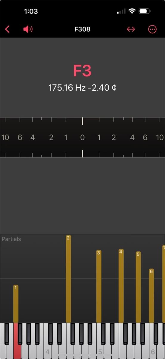

    The 'high tech' way of playing F3 and A4 is to use an app that remembers the full spectrum components from one of  your piano profiles. Pianoscope does this, for example. No need for tuning forks that may or may not be any where near as accurate and may vary with temperature, etc. Pianoscope is accurate to hundredths of a cent on all the partials of any given note you play. The audio output sounds like the actual piano but with full sustain.
    Here is a picture screen shot from my Pianoscope playing F3 remembering my Fazioli piano curves and settings. Notice it shows -2.4¢ which is from my tuning curve which incorporates a combination of Pure12th temperament and my IH on that piano, so it knows my F3. If I wanted F3 by another temperament or another IH, that can also be done in Pianoscope. Let me qualify that I am 'not' a rep for that app, just an expert user.
    There are also very inexpensive apps that will play pure sine waves from your iPhone.
    F3 from Pianoscope from Fazioli
    Steven Norsworthy
