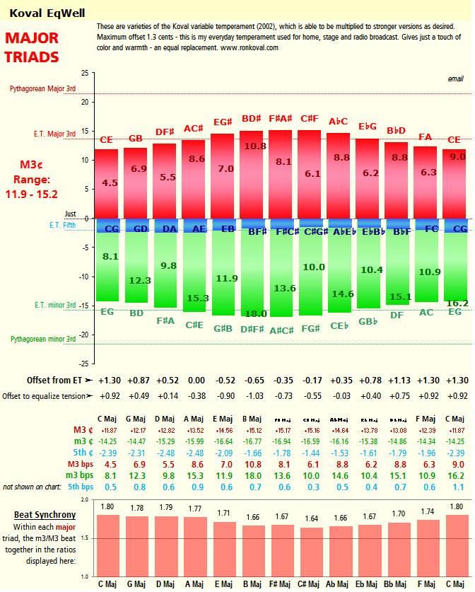

    A little more than a decade ago, I was working on different temperaments and wanted to develop one that was very mild, with the smallest offsets. With the ongoing discussion, I thought I'd share this one that has a maximum offset from ET of 1.3 cents.
    It is surprising how little it takes to give a tuning a slight slant in the Well temperament direction. I use this as an ET replacement - it probably would pass as such, but all of the 'errors' are carefully constructed with a progression of intervals in mind.
    Obviously, the better your chosen ETD is able to craft a clinical ET and appropriate stretch, the better any temperament will turn out. I'm currently using PiaTune for iOS that has an assist function for finding the best stretch. Graph from rollingball.com

    Let me try again to attach the graph....

    Ron - that's a very smooth key progression. From the Rollingball information it's not clear what offsets one might insert into an ETD so as to be able to replicate it - perhaps it would be helpful to list them in this thread either from C or from A and also possibly to plug them into the spreadsheet I posted on the P12 thread to see what extent the tuning has an effect upon resonance.
  • 4.  RE: Nearly equal
    Posted 04-16-2024 08:29
    In the black directly under the green stuff...offsets. You need to hop around a little with it but they're all there. I just plugged them into my piatune program and am going to give it a try.

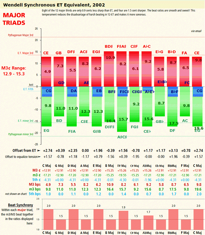

    Dear Peter
    What is confusing there is that it appears that that line is arranged by fifths rather than chromatically . . . unless I'm mistaken? For plugging into a machine it'll be necessary to re-order . . .

    So I just tuned the temperament according to the plan and my assessment is that it is nearly identical to EBVT in its current form. The primary difference that I can clearly detect is that whereas EBVT makes F-A, G-B, C-E, and G-E (generally speaking) sound the same at 6bps, the EqWell does not do this which reduces one or two fairly fast 4ths and 5ths in the EBVT.
    I can see how this can produce decent key coloration and simultaneously not produce anything objectionable to most. The dissonances are in all the right places making the consonance in the simpler keys better. So far I'm impressed. I'll now continue through the piano.
    Nice work Ron!

    Yes, getting the offsets from the rolling ball site does take some careful bouncing around!
    A 0.0, A# 1.13, B -.65, C 1.3, C# -.17, D .52, D# .78, E -.52, F 1.3, F# -.35 G .87, G# .35
    I'll try later to see if I can get your spreadsheet working on what I have here.

    I like it!  I'll rate it as "halfway" between ET and EBVT. A nice variation.

    Plugging the figures into the spreadsheet we see, of no surprise, that it's very near to Equal but with the satisfaction of some key colour and which would be your intention:
    Proportion of same frequencies
    Equal 38%
    Kellner 43%
    Koval 1.3 38%
    Around 1 beat
    Equal 15%
    Kellner 9%
    Koval 1.3 14%
    1 to 5 beats
    Equal 33%
    Kellner 28%
    Koval 1.3 33%
    2 to 5 beats
    Equal 16%
    Kellner 17%
    Koval 1.3 17%

    Here is another "nearly equal" with a different goal - to syncronize the combined beats between the M3/m3 in a triad. An interesting spreadsheet creation. The bottom part of the graph shows the ratios.
    For me, I found playing this that it felt "unsettled" in a way similar to how I feel when playing any of the P12 tunings. Of course my "unsettled" could be another persons "vibrant". So many areas of our work can be percieved as a positive or a negative...
    And to answer an earlier question - no, my Koval variable series doesn't have any aural sequences that I am aware of - it also came from spreadsheet work.

    Feeling curious.... Could someone familiar with the PTG test scoring for the temperament section give scores for these 2?
    KV1.3 A 0.0, A# 1.13, B -.65, C 1.3, C# -.17, D .52, D# .78, E -.52, F 1.3, F# -.35 G .87, G# .35
    KV2.1 A 0.0, A# 1.82, B -1.05, C 2.1, C# -.28, D .84, D# 1.26, E -.84, F 2.1, F# -.56 G1.4, G# .56
